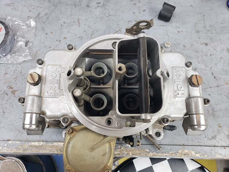

That is an absurd idea sir.....  :P  What kinda person would take a 3310-2, knock the boosters out, install annulars in the primary, stepped downlegs in the secondary and put those on his car?

Why I ran a Holley 84011 for a while - what is now the Summit carb 750.  Uses a front (and rear) annular venturi assembly very similar to the Ford 4100.  Uses all other Holley parts - jets, vacuum diaphragms, accel pump parts, etc.  I used that on a mild 351C street engine, 11" converter, 3.23 gear but with a big Weiand single plane on the engine.  Great carb, still sitting up on the cabinet with a bunch of other spare carbs.  Drove nice, no hesitation on street or track.  I quit using it because Holley discontinued the 4010/4011 line and parts dried up - specifically the booster unit, which you had to drill to tune pump shot.  Now that Summit sells the carbs, might be good again on the right motor.  I wonder if they have a better time moving the carbs - Holley I think had sales trouble because "that don't look like no Holley I seen".  :)

See whacha think of this LOL
