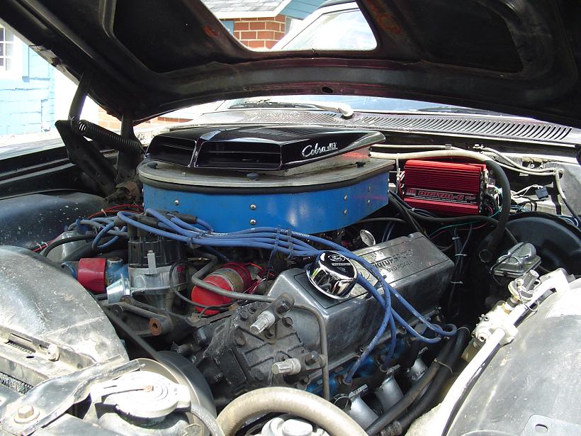

If it fits under then don't run a scoop just to give more air cleaner clearance... that is "ricey".  There are plenty of SuperStock cars and circle track cars that have minimal carb to hood clearance and they run fine. You can gain room by not using a top lid and seal the element to the underside of the hood with a strip of black sponge type foam. The ***cough*** Corvette***cough*** air cleaner base drops more than most aftermarket ones and can allow a 3" tall element to barely stick above the carb.
Lowering the motor by altering the mounts is another option.

When I run it at the track I take the aircleaner off. Since I made my own frame mounts I already have the motor as low as it will go.  I am still thinking it over. What I might do is make my improvements, see what it runs like then run it with the hood off to see how much if any it helps.

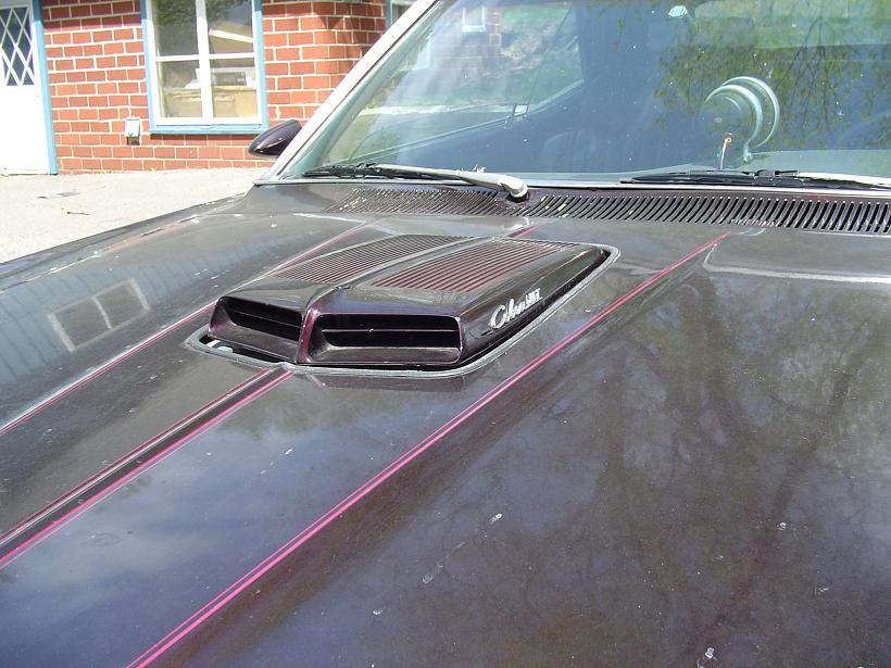

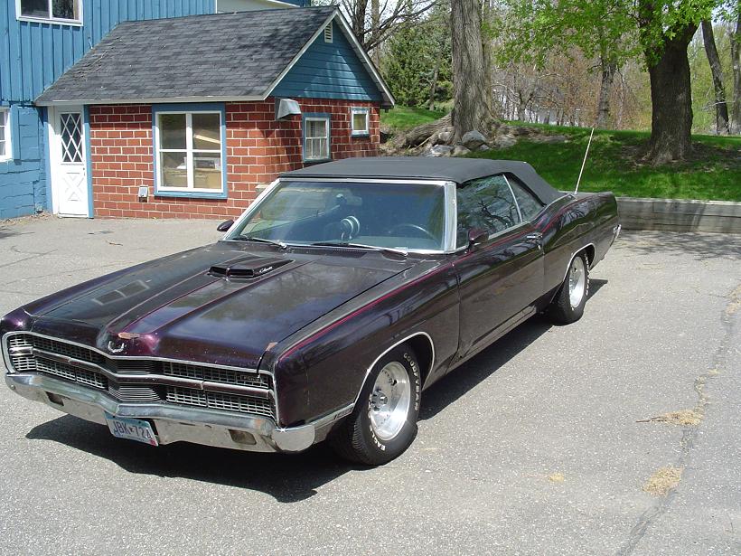

I think those teardrop hoods look great on the early Galaxies, not so much on your year, Alan.  I had the same problem with my 69 Galaxie convertible, and adapted a Torino shaker hood to it.  Worked out real well, and the fresh air package picked up 3 tenths (!), although it was only a 15 flat car to start with.

With a sealed base to the hood, was worth .3 and 3 MPH in 1/8 mile vs underhood air.
