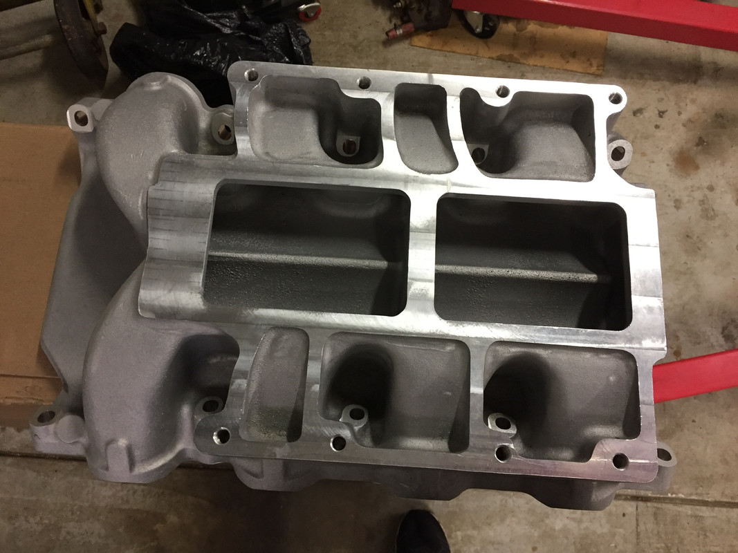

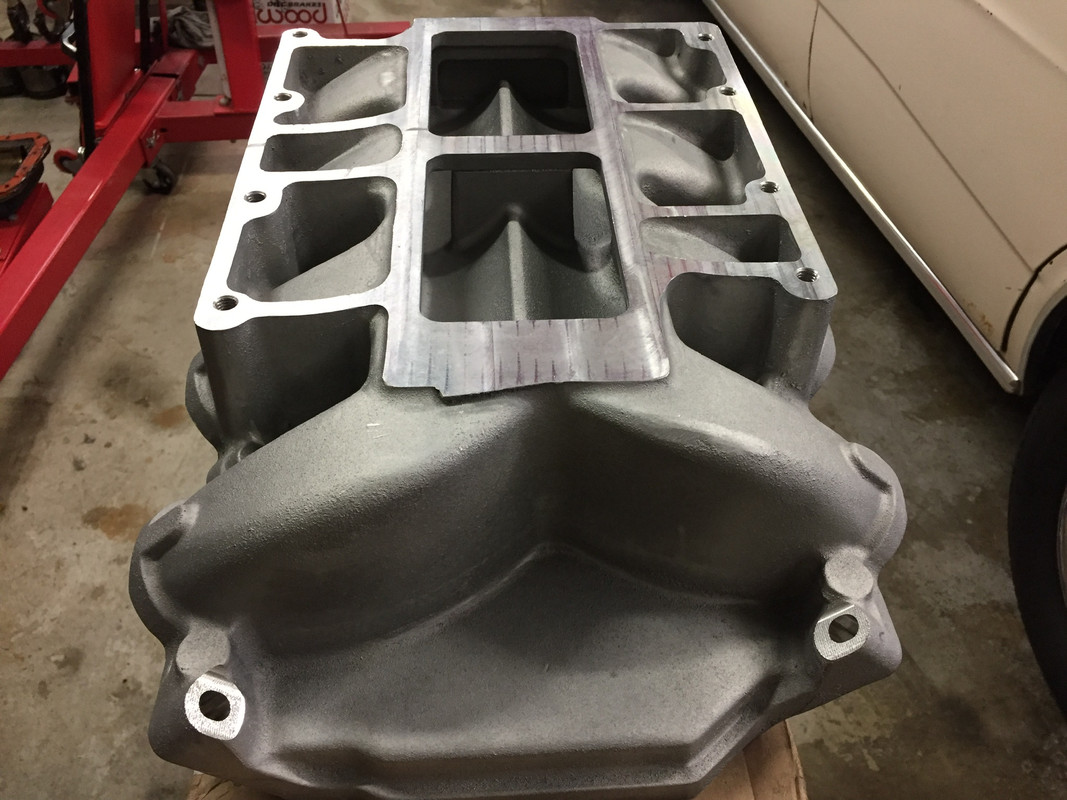

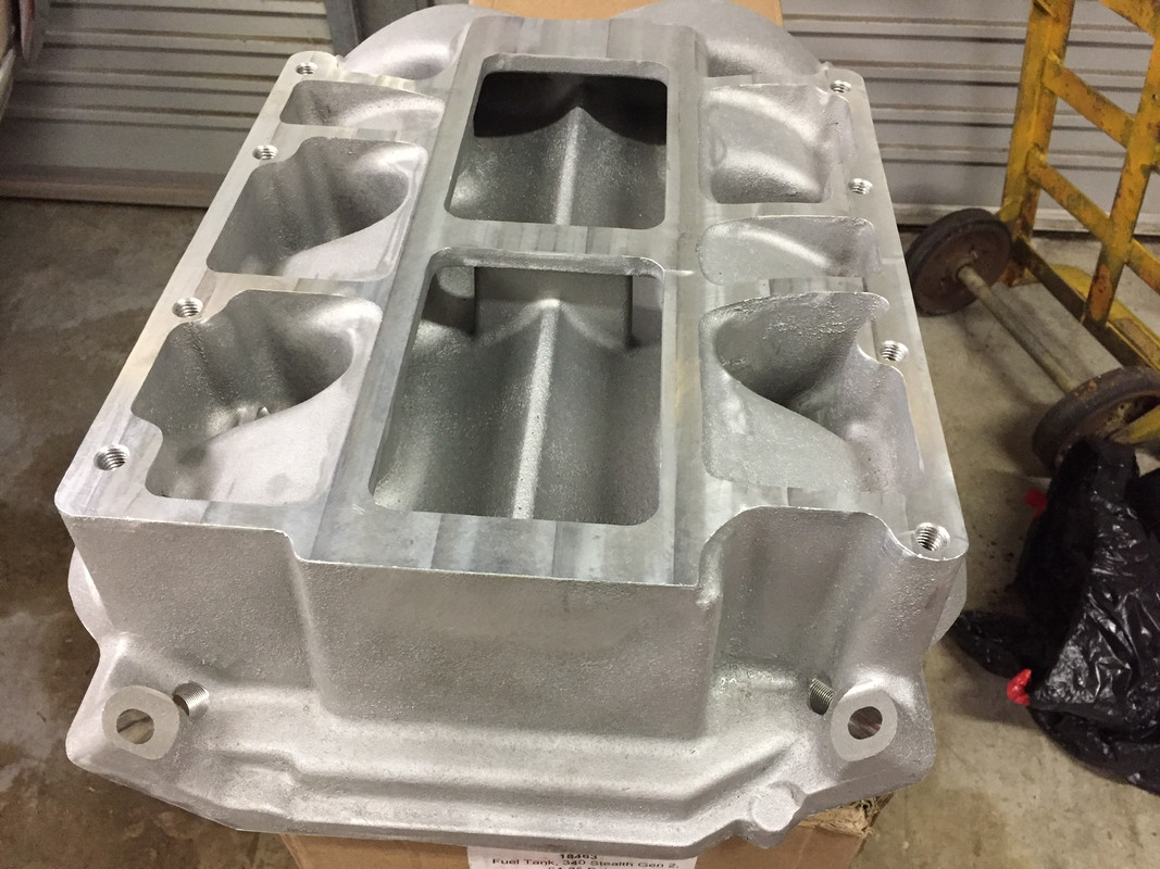

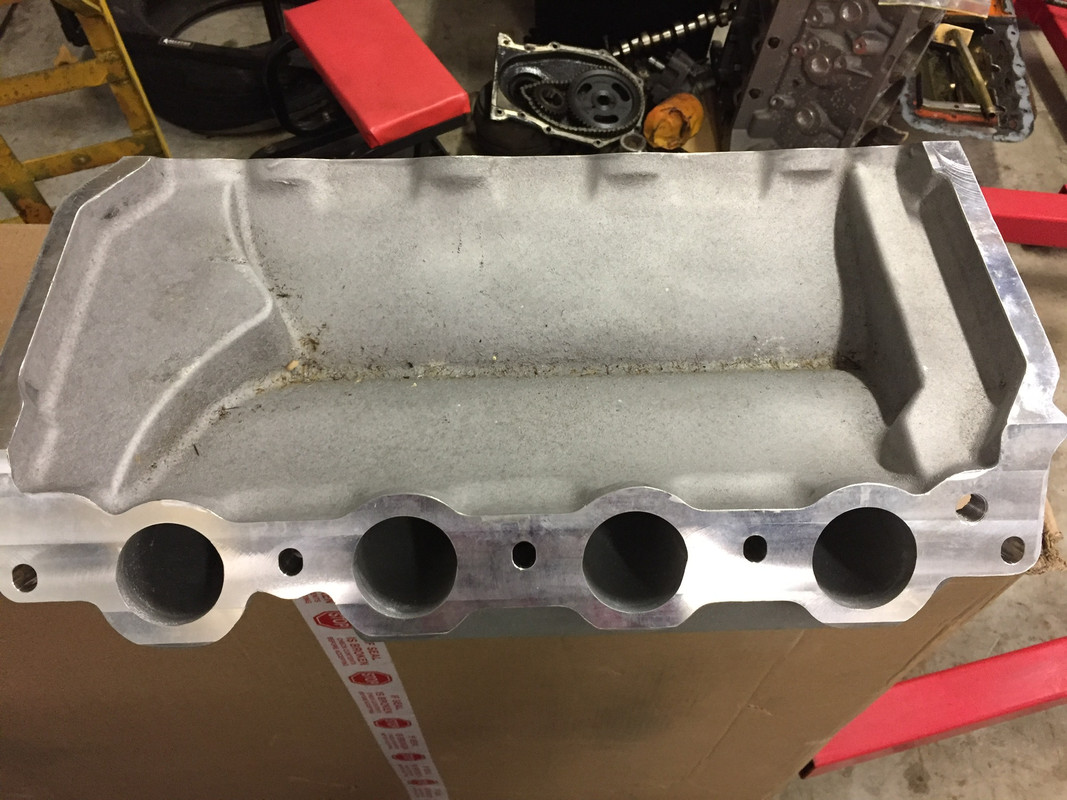

Here are some pics of the Munro manifold I have.
Front
Rear
Top
Underneath
Hope these help you. You can see the water outlets that Jay mentioned on the rear of the manifold. There would probably be enough material on the front of the manifold rails to drill and tap for water outlets there also.
