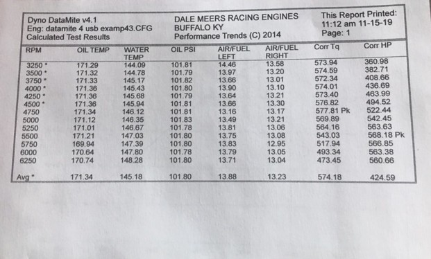

Performance Summary:
      Cubic Inches:    461    Dyno brand:  Stuska
      Power Adder:               Where dynoed:  Dale Meers Racing Engines
      Peak Horsepower:   568 HP @ 5500 RPM      Peak Torque:   577 @ 4750 RPM
Horsepower and Torque Curves:

Dyno videos added
https://youtu.be/NGMBnI5msWY
https://youtu.be/Acsm_Jm1xHc

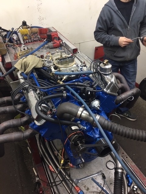

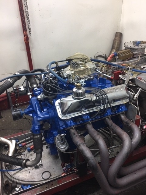

Additional info and observations on this build
There is likely more in this engine, it outperformed all of our expectations by a significant margin, but......if you notice the oil pressure, that is a pegged 100 psi sending unit on the dyno, the actual pressure was approaching 130 psi.  It turns out that there was likely a stuck relief, but I also added the provided 10-15 psi shim that Doug provided to the standard spring.  Lesson learned after a quick call to Doug, is that you can push the cup plug in farther than it needs to be and raise the pressure more than you think.
So by pulling out the shim, and setting the cup plug properly, I likely would have dropped 25 psi, but when I disassembled the pump the relief came out sort of easy, but needed to be helped.  Once I washed the relief and cleaned it's bore with a brush, the relief would fall in and out as expected.  I normally work the relief on a fresh pump, but this was a safety wired pump, so I didn't go inside to see if it was stuck, in hindsight, I wish I would have dropped the relief out when I added the shim, new rule....pressure with the priming tool by hand was about 80 with cold oil so I expected it to be good,well, it wasn't LOL
Second was, although we tuned this one to a knife edge with jet, transfer slot restrictors and air bleed work, we did not even attempt a spacer of any kind.  The reason was that we far exceeded our goals and with the 68.5 Ram Air air filter, there is no real way to raise up the carb, so rather than just coming up with hero numbers, we left it with only a 1/4 inch insulated gasket
I really think the engine would have responded well if it wasn't pumping so hard and we gave it more plenum.  No idea how much more, but my gut says there was 15-20 more in it with no cam change.
Regardless, 68.5 Mustang, 4 speed, 3.91 gear should haul the mail!
« Last Edit: November 17, 2019, 11:06:18 AM by My427stang »

Ross, did any of the A/F tuning efforts result in a pull where it was richer at the peak numbers? Wondering what the results were at 12.5-12.75 if such a pull occurred.
I like those numbers on a 10.3 compression engine. Nice combination of parts.
JB
Yes, we had it slightly richer, and tuned WOT, cruise and midrange with an air filter on for most of the tuning.  It lost 4-6 hp at the peak when fat, but I do not have the printout of those
This was a very easy engine to tune, when we slapped the carb on, no tuning, timing or otherwise, it was 556 HP at the peak, had to pick the owner's jaw off the floor, but it did go up in 5 hp jumps with everything we threw at it, but in the end, it was a very happy engine
