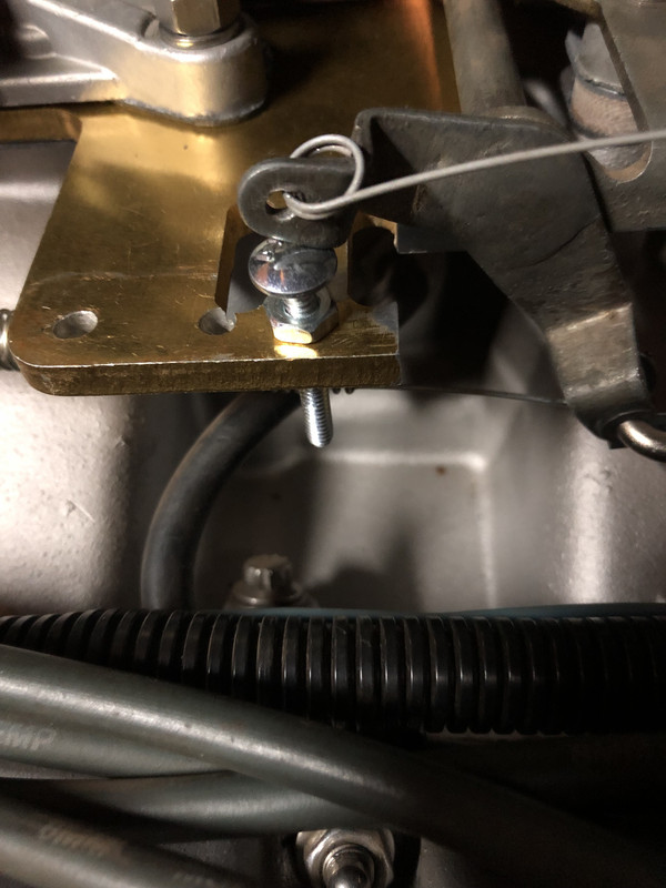

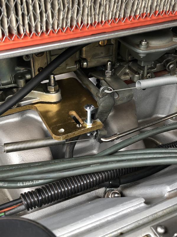

As a more permanent solution, and to give me the ability to close the throttle more so I could slow down to 12.00, I fabricated this - I took an aluminum plate I already had on hand ( from a Moroso  throttle cable plate ), and drilled & threaded a hole for a bolt I can adjust, which the stock Ford 2-4V jackshaft contacts to keep from going full throttle. I recently ran this, and after a half dozen passes I got to 12.00, but it requires closing to less than half throttle to accomplish that. I keep a cheap caliper or small ruler with to measure the height I have the bolt adjusted to, and log it in my logbook.
Personally, if I were you, and guessing you will be limited on the amount of time trials you can make, I would not start with your plan of making a full throttle run, and then slowing down, but I’d start with a significant amount of linkage adjustment first, to try and safely be under a 11.50 ET, and adjust from there. That will also keep the track from scolding you, and gaining unwanted attention immediately. My guess is your first attempt may still be too fast, but if not, it’s easy to adjust a little quicker if you want. What I would do is put a small piece of tape on the threaded rod, to mark where originally you had it, to make it easy to go back to your initial full throttle setting. You can also use the tape as a spot to measure from, and log the settings.

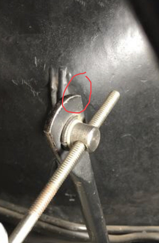

One of the local Super Stock racers has a really nice mechanical positive throttle stop on his SS/L ‘64 Mustang 289. One issue with our first generation Mustangs is the firewall isn’t flat near the accelerator rod area, it curves & kicks out. His solution was a thick block of aluminum mounted to the firewall, contoured to the curve in the firewall, but flat on the side facing the engine, and threaded with a large adjustable bolt that can contact the accelerator rod that pivots on the firewall. Someday I really need to get a picture of it to give a better idea. Using the picture of my accelerator rod, I circled the area that contacts the bolt head. It’s a really solid solution, and easily accessible to adjust. Many of the Stock & Super Stock racers ( especially Super Stock ) don’t run their cars full out, especially at local track S/SS events. It saves on wear, and helps consistency by cutting down on wheel spin, unless they have a heads up race.
