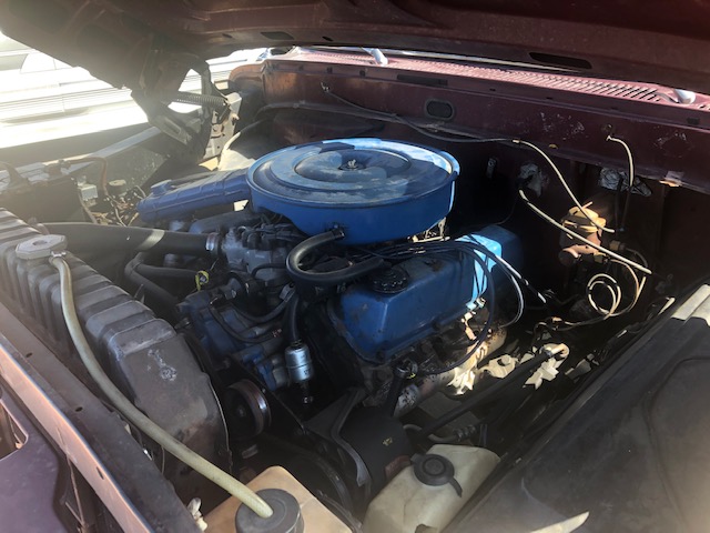

I was driving to a job site today and noticed an F-250 Ranger on the side of the road for sale. Stopped to take a look, the closer I got the better it looked. Super super original truck, original paint, body is straight as an arrow, maroon with black interior. I called the number on the for sale sign and asked the guy if he was OK with me popping the hood, I was really hoping to find an FE under the hood. I found a 429/460 sitting it in.
I started scratching my head wondering how the truck got a 429/460 in it. Everything looked entirely original. I don't believe they ever offered that truck with a 429 option? I'm 100% sure the truck is a '69. Did somebody swap a 429 into the truck at some point and just do a really good job?

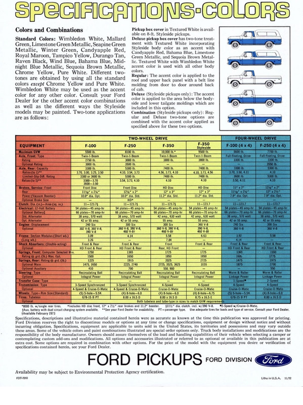

The first mention of a 460 available in a Ford pickup is in the 1973 Pickup brochure. And if you look at the fine print it says not available until February 1973, so not even available at the beginning of the model year. There is no mention of 429-460 engines in the earlier pickup brochures. I double checked in the Ford Truck Parts Book, and there are no listings for the 429-460 in the 1964-1972 series of parts books. Had it been available there would have had to been parts & info. They are listed in the 1973-1979 series of parts books. The engine code in the VIN would tell the tale for sure. Here’s a picture from the back page of the 1973 Ford Pickup brochure with the standard & optional engines.

Absolutely a swap....likely a good swap because it is an easy one using later model parts.  Almost everything swaps over
In fact, I wish I would have went that way in the 80s, but now I have so many FE parts that I can't get myself to swap the truck over to a big 385 stroker LOL

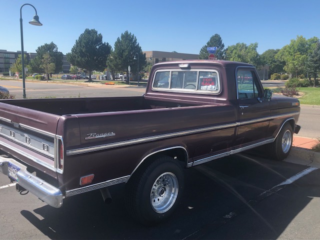

Thank you guys for the info. I did some more digging and believe it originally had a 390 and was swapped with a later 460 setup. If it had the FE in it, I think it'd be in my driveway right now. Super clean truck but am going to punt on it.
Some pictures I took:
Re: Need Ford Truck Knowledge - 69 F250
« Reply #8 on: September 26, 2019, 03:52:54 PM »
Idaho plates?  Likely why it is so nice.  I'd like to take it home myself.  ?
Curious what they are asking?  Likely a good amount.

Colorado collector car plates. The guy said it spent almost all it's life in Utah, then the last few years here. Was asking $9,000 but was open to offers.
I considered it, but really don't want to deal with the 8 lug wheels, heavy rear end, and all that good stuff. 390 F100 and it would have been sold sold sold.
