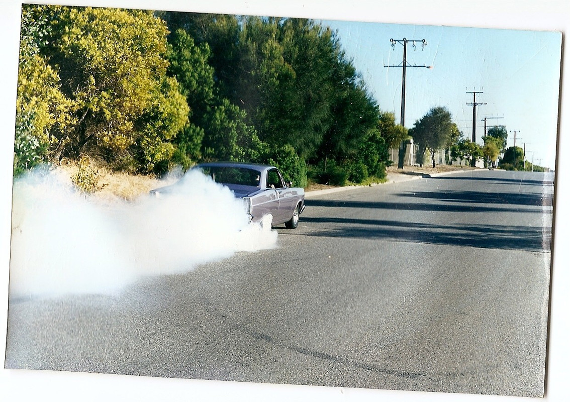

This is a little story about when I first bought my Fairlane. The 390 had a Crane Fireball 294, 750vac, standard converter, C6 & 2.75 gears (it would do 110MPH in 2nd). My daily (and I know most of you guys will not know what this is) was an XE Fairmont Ghia with a fuel injected 250ci 6cyl, 5 speed manual, bone stock. My Fairlane got better fuel economy. Of course then I narrowed the LSA, put a 3500 converter, 3.89 gears amongst other things in and it was all over! I never measured the economy but it was impressive.
