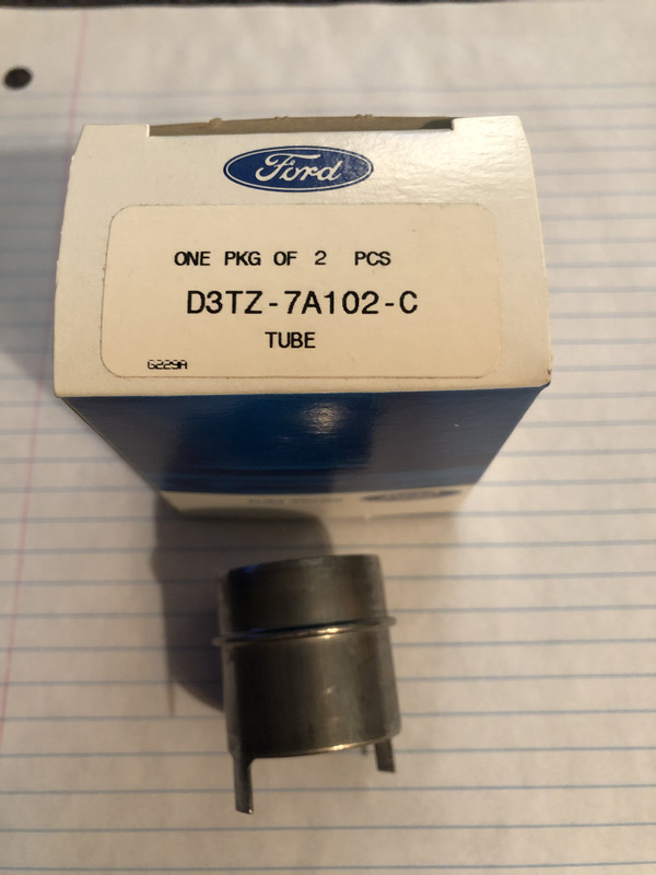

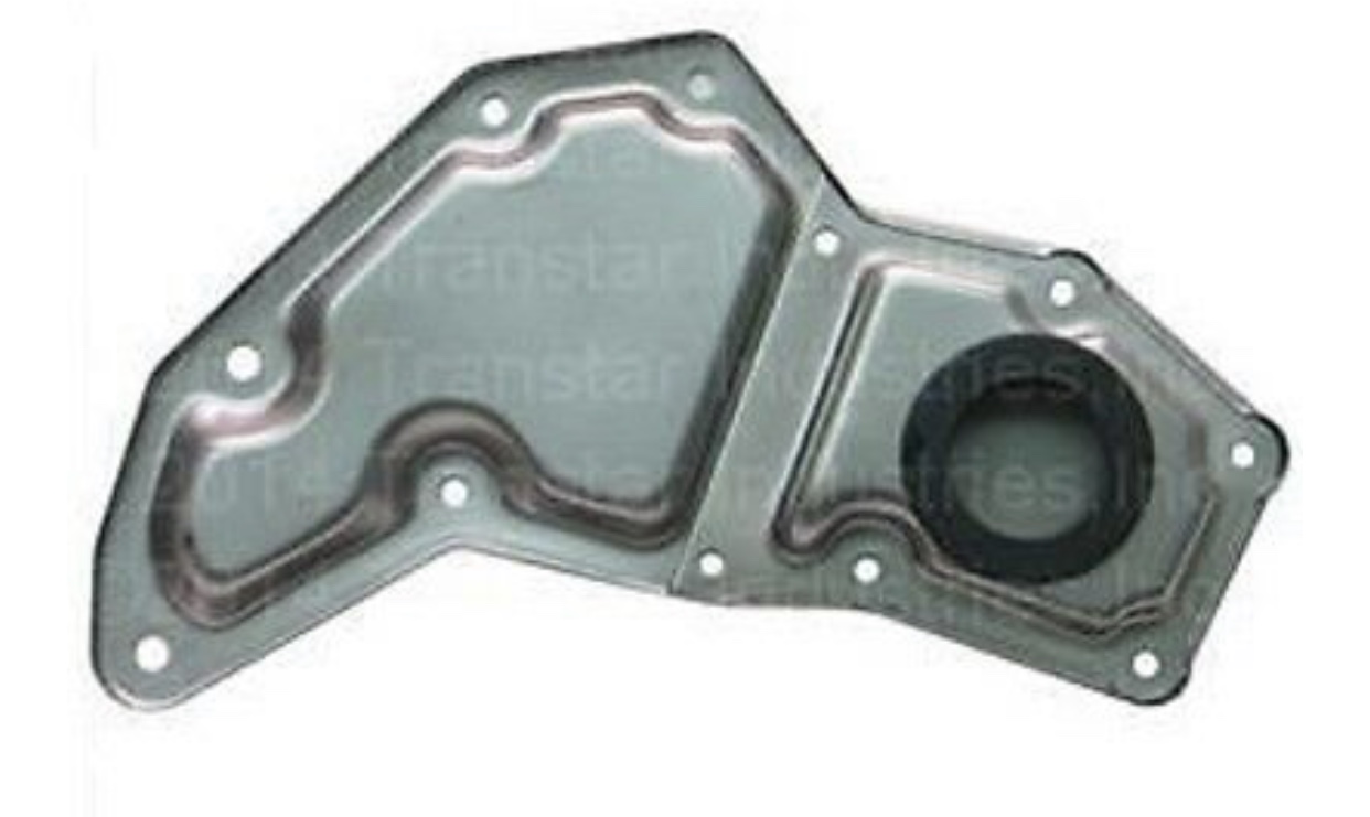

Ford had a factory deep C6 pan on the ‘70’s 4x4’s, and used a special filter with a hole & grommet and a push in extension. I use these myself. Chris makes a good point, I’ve seen people on the internet claim they don’t use the special filter & extension with their deep pan C6, it would be a good thing to check if you have a deep pan. Here’s a picture of the filter & extension. The extension is obsolete from Ford, but there are new replacement versions available.

If there is a "deep"pan on it, make sure it has a matching filter.  Not sure on C6 but we have those available for a C4.
Deep pans are available for the C-6.  I installed a TCI deep pan on mine and it came with a new filter, filter extension tube, and gasket.  A quick check on Summit Racing and it appears that all the deep C-6 pans come with the extension tube.
