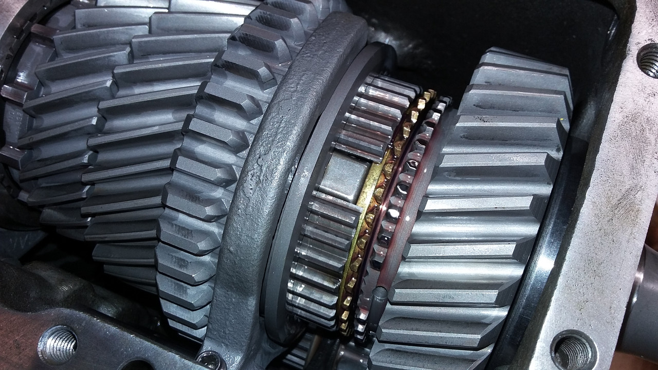

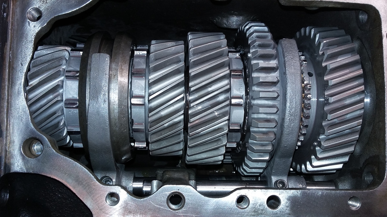

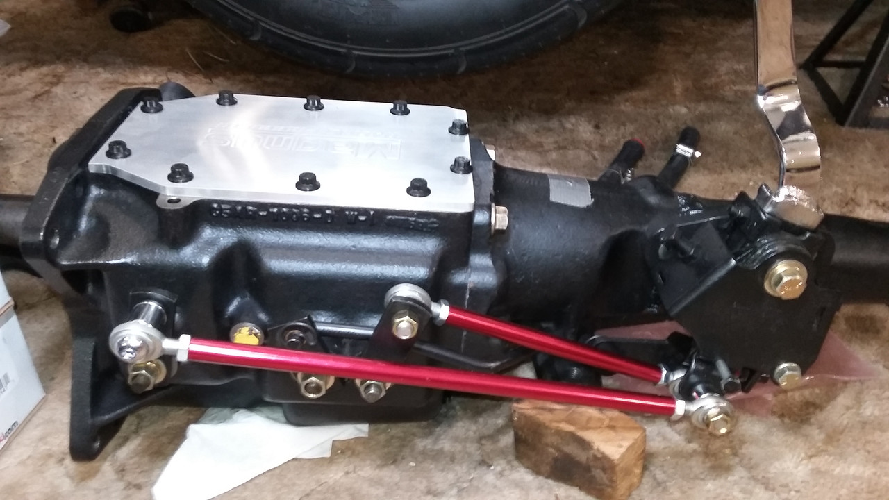

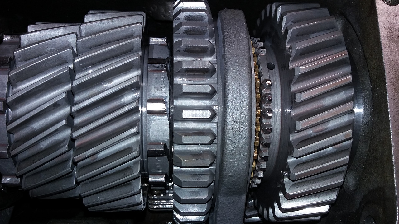

Here's a Toploader I built for a customer with synchronized 1/2 gears and faceplated 3/4.   Second gear is pretty hard to miss, so keeping the 1/2 synchro intact makes it a little more streetable.  When you need to hit 3rd and 4th, it's stupid easy with the faceplating.  I paired this one up with a Long inline shifter.  Bang, bang, bang.
