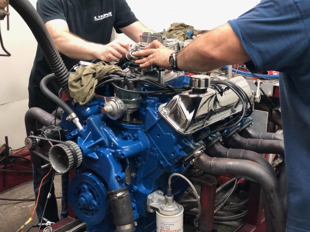

Some pics
Color wasn't nearly as bright as it looks, was painted in the correct color with flattening agent, camera flashed on me making it look a little bright
Here it is on the dyno, me on the right, Brent on the left, after giving up on the CJ carb LOL
Here is another on on the dyno after a couple good hero runs
Stay tuned, this one (if I don't get lazy and just drop it in)  ....  and a TFS headed resto-disguised hero coming up next :)

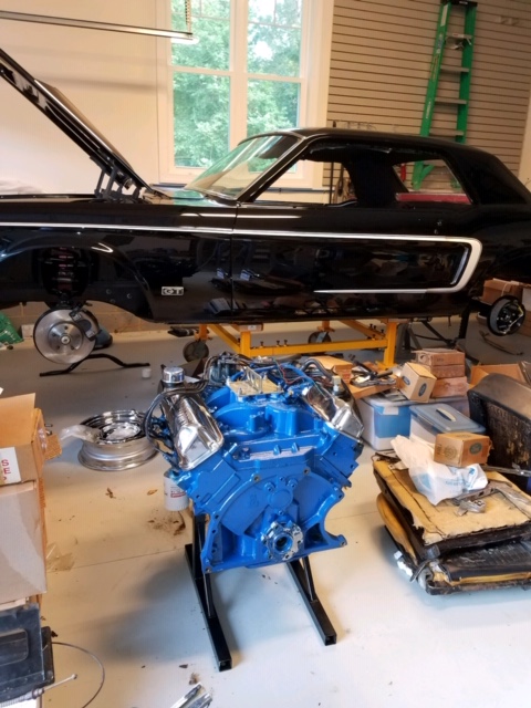

I imagine it will be at every CJ meet it can attend next year, along with it's slightly more burly twin from North Carolina.  That one hits the pump in November....
It's getting closer to the car at least!  Got there from Nebraska via Kentucky to the east coast

I saw both the car and the engine on Friday.  Both look outstanding!  Will be awesome to see it hit the road.

Joe is exactly right, but in this case it isn't a modified car, the car in the picture is an original 4.30 4 speed Cobra Jet Coupe.  Very limited numbers.  The engine on the stand today is for a sister car, another original 68.5 4 speed CJ Coupe, a little different gearing and C-stripe, but basically it's twin
My 489 inch FE is in my 70 Fastback, we did all the things Joe mentioned and more to tighten it up as it came with a 302/C-4 combo.  Ultimately for 67-70 it's a bolt in though, because they came originally with 390s and 428s
Jealous I missed the party!  Of course Danny not only has a man-cave we'd all be jealous of, but he clearly wears the pants of the family because he took over the main garage too!
