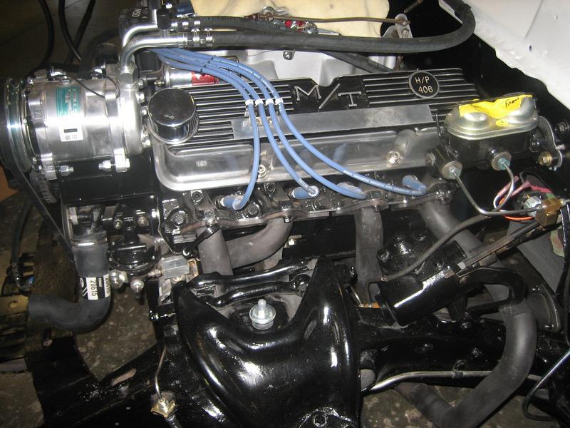

Paul, I have a 1" Thermal spacer an electric fuel pump back at the tank, ceramic coated headers wrapped my fuel line with reflective sleeves any where near a heat source.  I think the elec. pump helped some
   Since my hood open clam shell I've even gone as far as letting the hood lift about an 1 1/2" to a stop I have on the fender, but that defeats the air conditioning because the fresh air inlet is in the cowl.
   I was wondering if my drop down air cleaner pan is trapping hot air under it.  But then I would have to find a standard flat type pan and a 14" x 2"  blue element.  But thanks for your help
Bill
Bill - when I look at the first picture it seems the fuel line runs across the front of the engine and then back down the passenger side to the carb inlets. I ran mine in from the rear and up the back of the carb. I did this because I was hoping to put a stop to the vapour lock. If I had had the chance I would have run a return line as well - I have read that this will also help with fuel heating since it is constantly cycling and not sitting in the line - but I am running the original in-cab tank and I couldn't without changing out the tank. I did put in a bigger line but was strongly advised against running a return line in the original fuel line as the difference in size would result in high fuel pressure at the carb.
In any case, what I did solved my issue before I had to go to further lengths. Since you will have to run a high pressure fuel system with a return anyway, you might just start there and see if it sorts you out.
