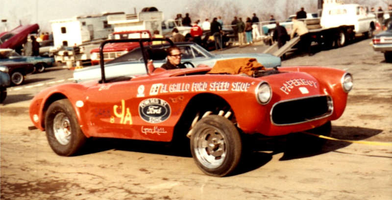

This (literally 'in the weeds') El Camino had a 428.
Re: An interesting offer: put a 428 in an '88 Corvette.
« Reply #7 on: July 16, 2019, 08:44:10 AM »
Yeah, that's the '63 Vette (corrected!) I believe Jay mentioned and I remember too as it was very unusual.....for sure! What was the year/month of that S&C article btw?

Yeah, that's the '64 Vette I believe Jay mentioned and I remember too as it was very unusual.....for sure! What was the year/month of that S&C article btw?
That's a '63 split window, the holy grail of Vettes. Nobody wanted them in'63 as most thought they were ugly. Some even cut the center brace out & put the one piece glass in from a ''64.
