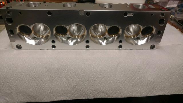

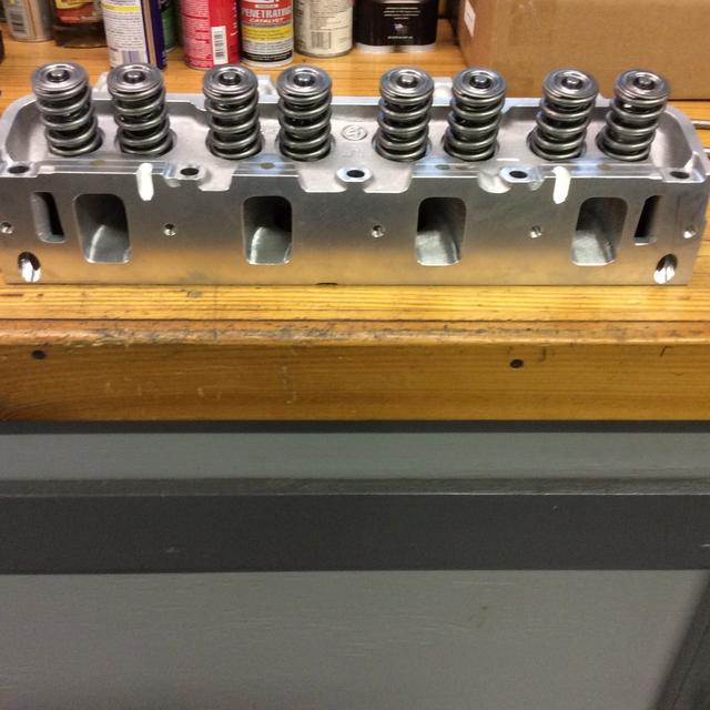

Here are a couple pictures of the heads Blair sent me before they got mailed out.
For comparison's sake.... a "street" pro port.
