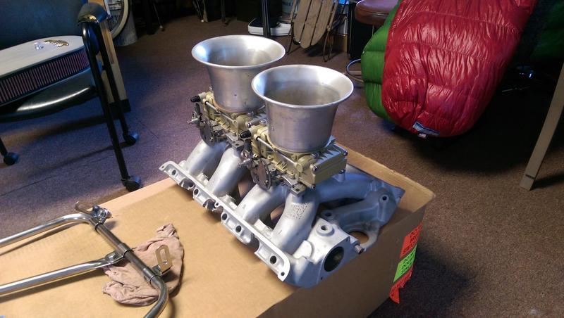

Chris, thanks for that link! Somebody on here made a set out of some sort of round fryer screen, so I'm looking into that, but those would work good when I just needed something quick and handy.
Not that it really matters, but my stacks are an old set that has a slightly bigger and slightly taller profile on the rear one. You can't get that today, but it adds to the vintage '70s look, IMO. They're going on this....which is why I got the fiberglass hood. Like Bob, I wasn't cutting on my OEM hood...
