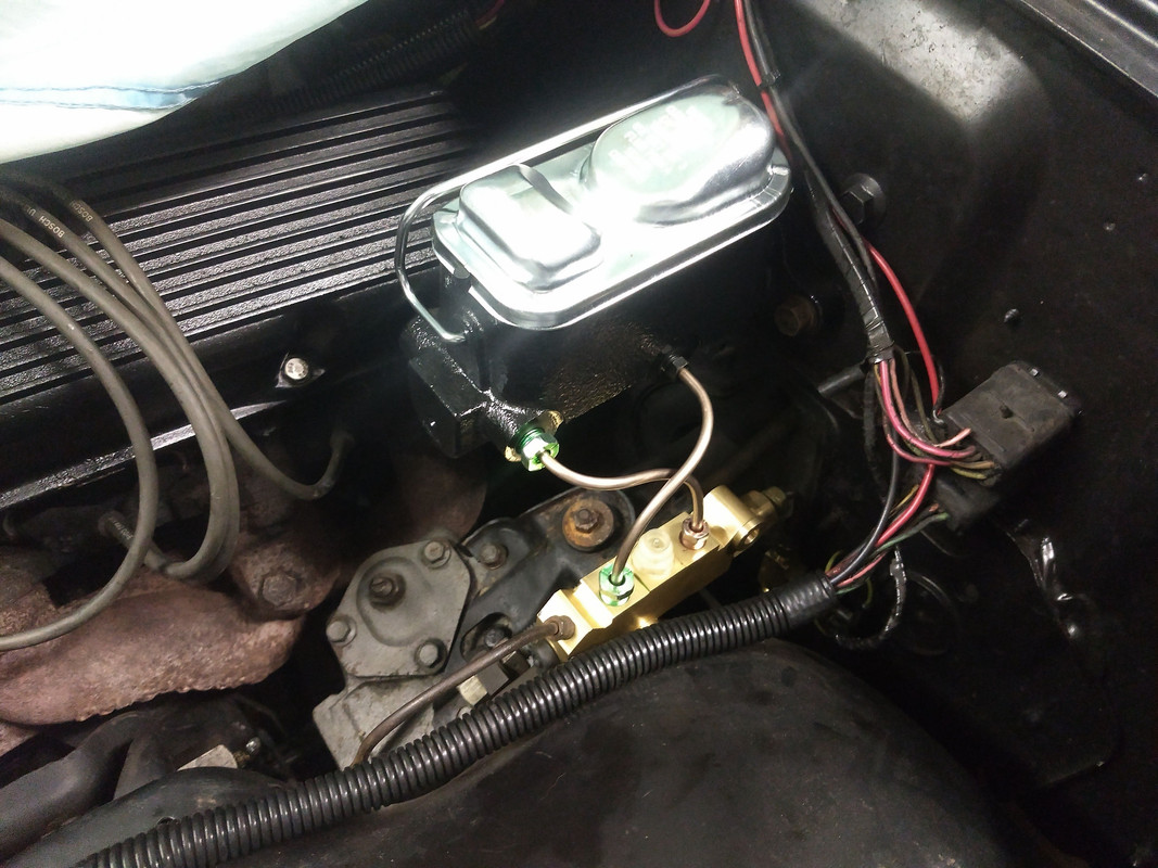

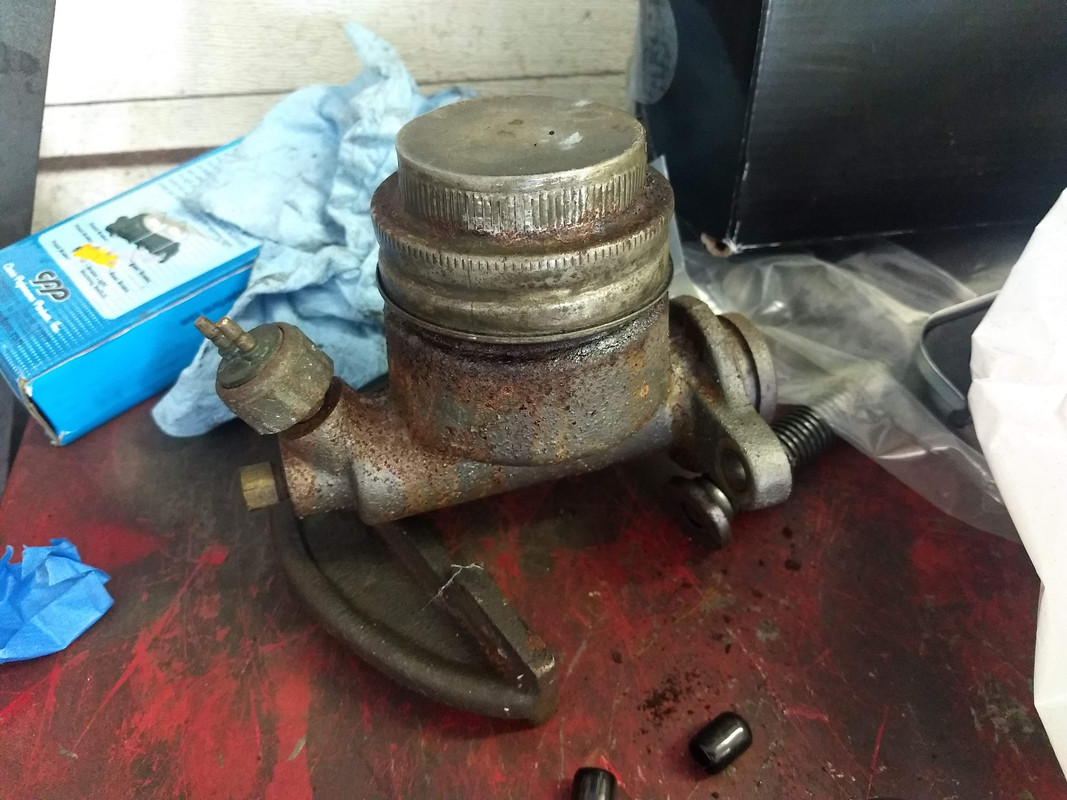

After 20 yrs of single master cylinder and drum brakes, I am upgrading the 2 dr to some better stopping power.

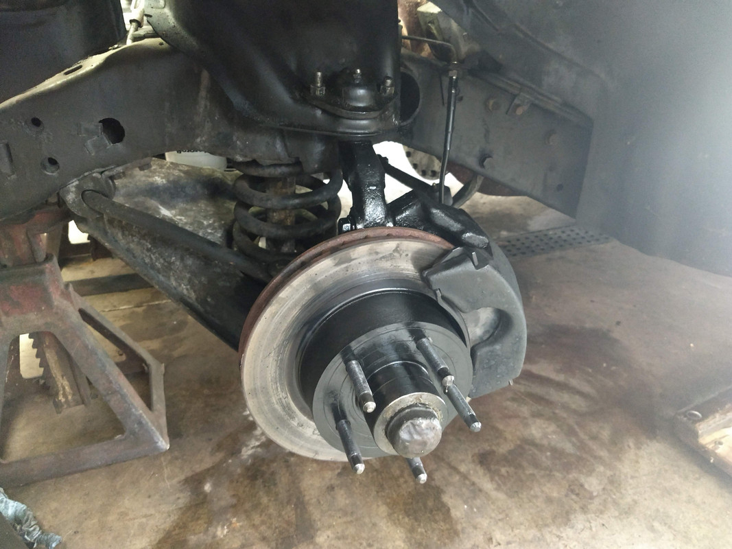

With taking the Tbird brakes off the wagon this past winter for some Wilwood updates, I'm reissuing the Tbird brakes to the blower car.  Something that is was much needed and I got constant grief over when people saw that little single pot master cylinder on that car.   :o

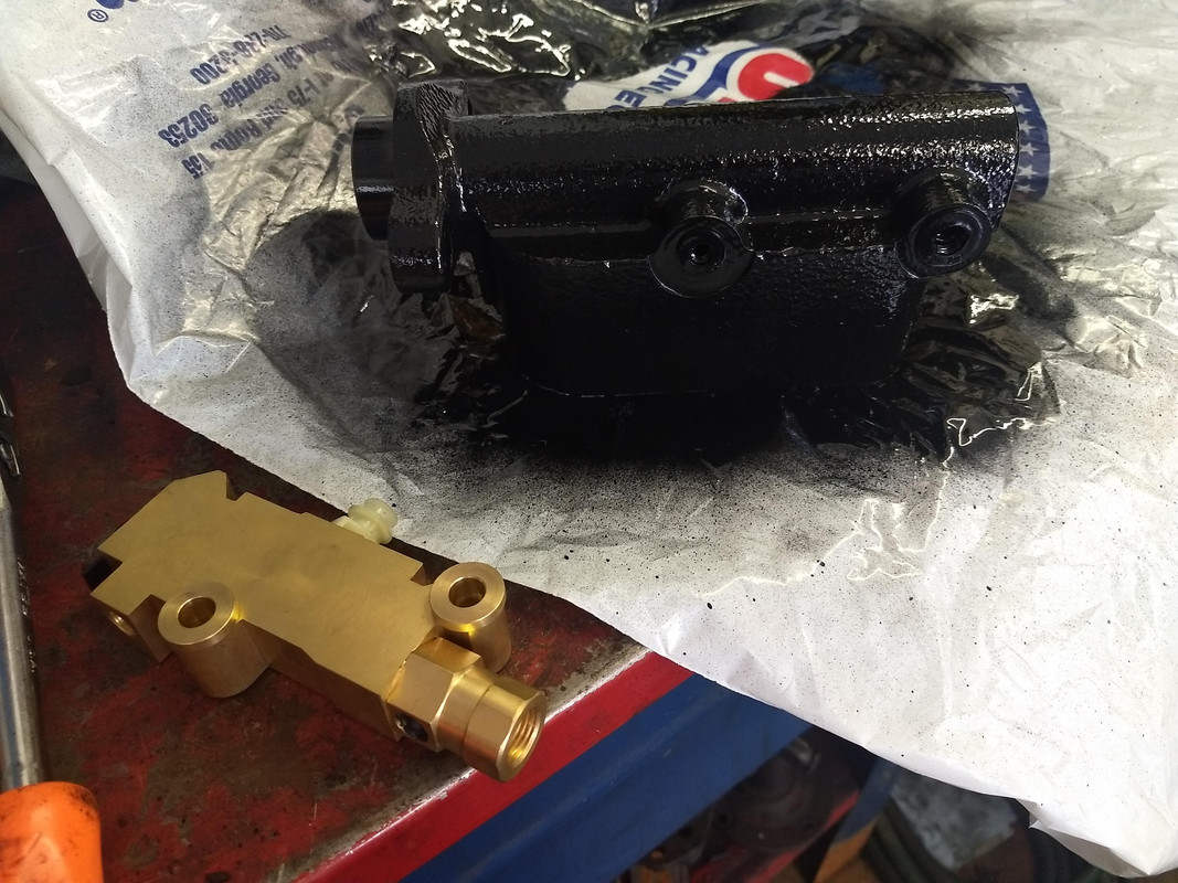

I cleaned up and painted the spindles, got some new Russell DOT braided lines, a new master cylinder and proportioning valve.   I got the m/c painted and mounted Sunday, along with the brakes.  I picked up some new line and appropriate fittings yesterday.  I have the two lines to the p/v fitted.  Now just need to get the rear brakes attached and the brake light switch.
I was hoping to get an adapter to convert 3/8"-24 flare to 1/8" pipe, but they don't go that way.  Only 1/8" pipe to 3/8" flare.  Ugh.  I'm going to have to add a 1/8" npt Tee and then get adapters for 3/8" flare.  Little more bulky looking then I wanted, but I can hide it down behind the steering box and still plug the pressure switch in using the original wiring.  I could go mechanical switch under the dash?  The jury is still out on that.  I'd like to just use the factory wiring, though it is not that important.

Back like 20+ yrs back, before the blower motor in 2000, I had driven the car to a buddies place one evening.  No problem.  I went to drive the car to work the next day and the pedal fell to the floor backing out the driveway.  Huh?   I unscrew the lid and it's DRY.  Bone dry.  How did it work fine the night before?  I installed the present single pot and it's been fine since then.  I put all new wheel cylinders on it before I even started driving the car.  Still don't know where all the brake fluid had gone?

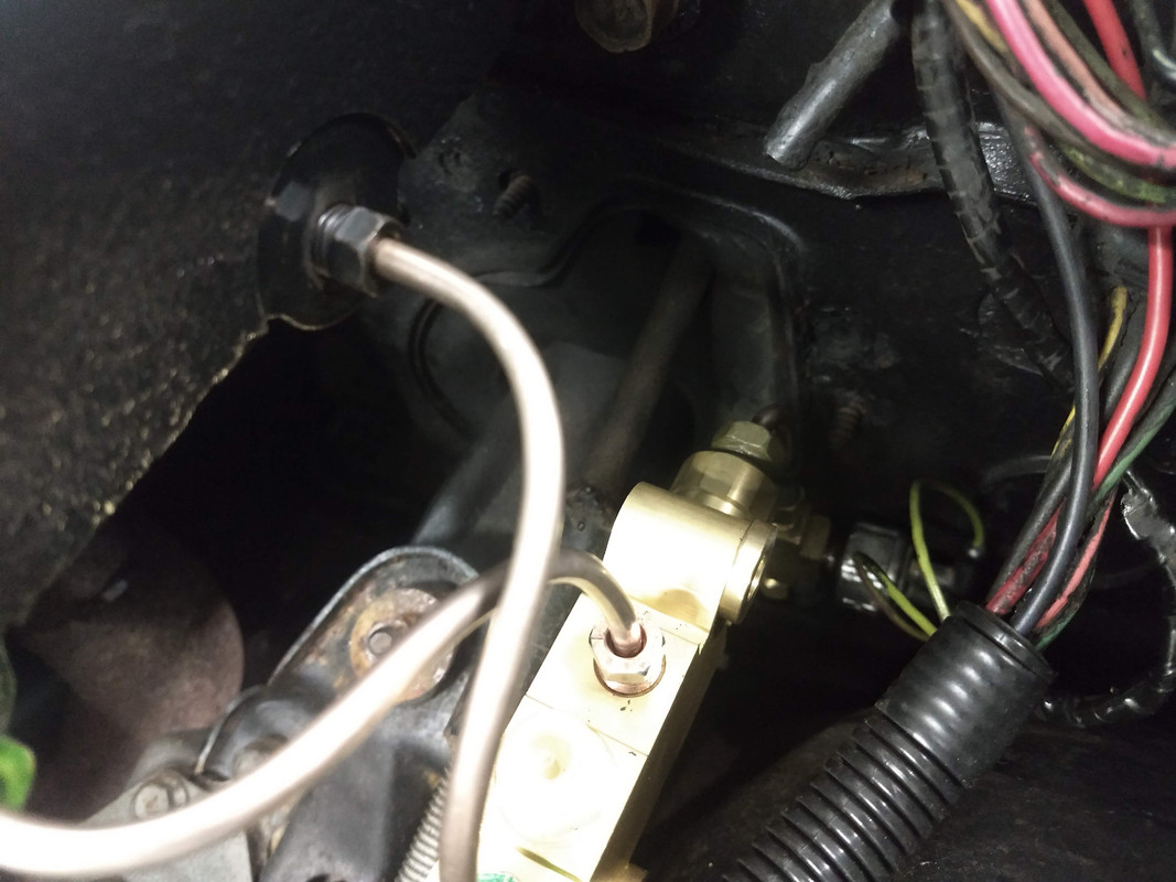

Here is what is done so far:
I have the two lines to the proportioning valve.   It's unfortunate that I had to twist the lines due to master cylinder orientation.   I prebent some coat hanger to help get it laid out so I could bent them some what evenly.  I'm not OCD, but I do try to make things look "right" to a point.  The hardest part is putting a tight 90* bend right after a fitting.  Never found a way to do it.
I got my pressure switch mounted, run in the rear brake line.
I reused the original block in the front to run the front brakes, I plugged the rear line port and trying to reform the line to come up the firewall to attach to pressure switch Tee.  I  used the existing front line to connect the block and the proportioning valve.
I spent some time trying to figure the m/c lines.  If I wanted them just straight down, I would need to reverse the PV, but that would make me redo the front brake line to come up the firewall and the rear would come out the front.  Didn't seem easier, so I did the twist version as shown.
I'm likely going to have to drop the drivers inner fender out to get the rear brake line attached.  Just no room to get in there.  The existing line is plenty long enough to reach the pressure switch, just can't get my hand in there to bend it.
The nice thing was the local parts store had all the proper line ends to attach everything WITHOUT having to use adapters!!!!
