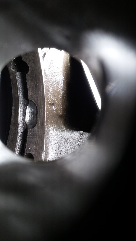

Broken off bolts is a thing that probably hit all of us
sooner or later. This is how i solve it, leads to victory
11 times out of 10
First i drill a hole and countersunk it in some piece of steel
Place it over the bolt
Weld and let it cool for a couple of minutes
Victory

Problem with a nut is that its a litle thick to hit the bolt
with the weld on smaller bolts, thats why i countersink
so its easy to start the weld on the bolt
After i have welded i try carefully to unscrew the bolt
if i feel to much resistance i build up more weld to heat
the bolt more and most of the times it is enough
Sometime when there is limited space i have welded a washer
to the bolt and welded a nut to the washer
