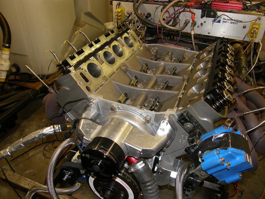

This morning we got going on the intake swap on Rob's engine.  We removed the tunnel port intake and Rob spent some time cleaning the gasket surfaces in preparation for installation of the single four intake.  When he was finished I took the opportunity to snap a couple of photos of this really cool engine, with the intake off:

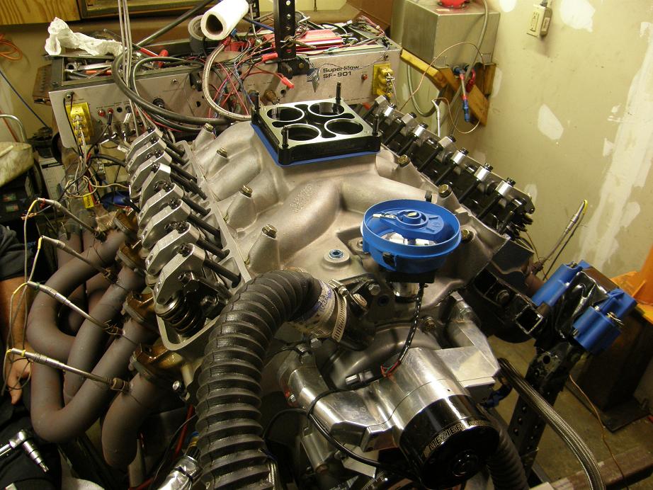

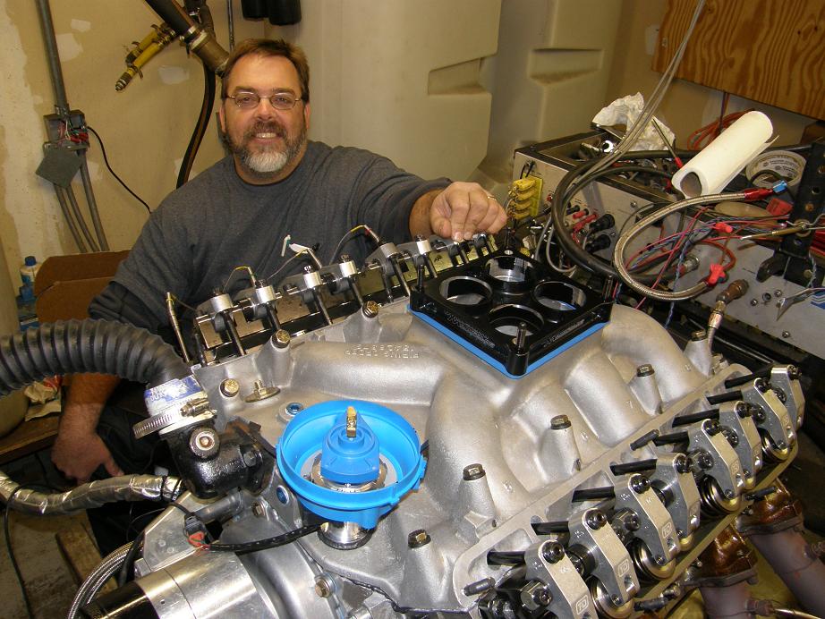

Next we installed the 4V intake and then re-installed the valvetrain.  Here's a couple of photos of the engine at this stage; the second one shows Blair doing the valvetrain installation on the left side.
We finished the engine off by installing my 1150 Dominator on the intake.  After installation we started the engine and ran it for a few minutes to warm up before making any pulls.  Unfortunately the engine didn't have crankcase vacuum any more, in spite of the fact that we re-sealed the distributor with The Right Stuff.  We suspected that the end rails of the intake, where we had used The Right Stuff to seal, just hadn't had enough time to set up, and that the leak was there.  Rob confirmed this later in the dyno session by noting that we had a minor oil leak at the back of the intake.  As a result of no crankcase vacuum, we expected the engine to be down a little bit on power.

The heads appear to be aluminum. Has somebody started casting TP heads? Or are they cast iron with a clear coat?
Is the HVC coil really duct taped to the mount or is it in the witness protection program?  ;D
Kevin McCullah
Re: Guess the tunnel port horsepower!
« Reply #29 on: November 12, 2012, 01:58:57 PM »
Those are factory cast iron heads, painted to fool people into thinking they are aluminum heads.  I see it is working  ;D
Yes, that is duct tape holding the coil in place.  The coil had one 10-32 stud that we were able to screw onto the front engine mount bracket for mounting, but it was in a rubber mount and the coil would flop around on the rubber without the duct tape.  -2 for style points on that one...
