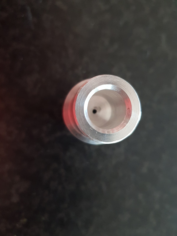

I was using a fixed orifice one I made with my efi for consistency.
