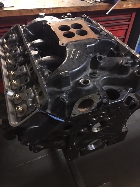

I am building two 461s, one is a CJ replica and will look stock, the other an EFI.  All the block and head machining was done, so I mocked them up to see what I had to do for machine work to the intakes.  The ironic part is that the one that will likely make the most power, looks the most sedate :)
The CJ will be a stout all iron 10.5:1 hyd roller motor, low 240's duration, 300 cfm CJ heads, 2.15/1.70 valves, and soon to have some nice work done on the iron intake
The EFI motor is an all iron 9.7:1, 230/236 hyd flat tappet, 280-ish cfm truck heads that are opened up pretty good, 2.09/1.67 valves, and a little rubbing on the Victor EFI intake
As I expected, both intakes fit great, the heads and blocks weren't cut too much, and it should work out well.  Now it's just plenum work on the CJ intake and a little rubbing on both
They will move a bit more slowly than I'd like as I wait for parts and sneak some time off but thought you'd like to see the contrast between the two :)

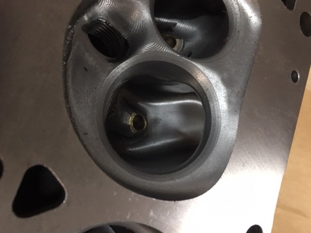

So we gave Lance Smith a try, he runs Craft Racing since Keith sold off and he does CnC programs for iron heads, only one I know of.  He was able to match all the chambers, unshroud the valves, and work the port to flow over 300 cfm.  You'll see a cut to the floor, but it's misleading, he didn't change the entry significantly, but did work the short side and the roof.  I cc'd the intake ports and chambers and came up with 158-160, so not a lot of cutting, and a big 83 cc chamber, which makes sense with the unshrouding and valves.
Some pics below:
You can see how he dipped into the quench pad and opened up around the spark plug.  I hate giving up quench surface, and don't love a big chamber, but given it will be .041 quench with a flat top,  and we are watching compression and cam choice, it should work well.

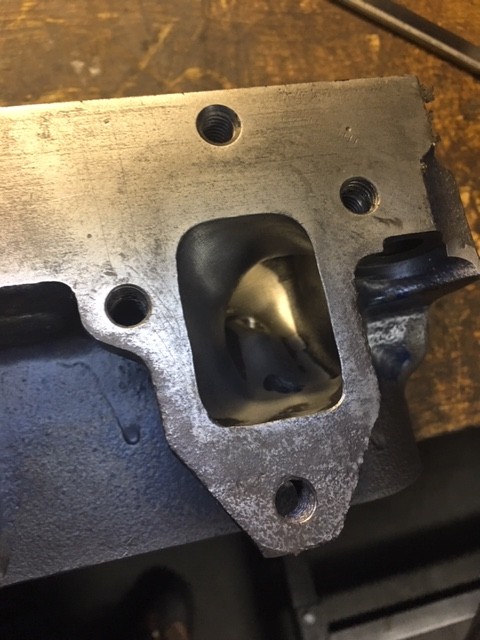

The exhaust port came out nice, Just a note, the exhaust gasket surface is not this ugly in person, the camera makes it look rusty, it's in decent shape

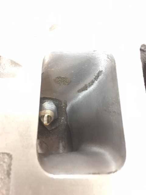

The intake port will likely work well too, although I was surprised to see a small cut on the bottom.  Also, those dirty areas are areas the CNC did not cut.  I probably will hit them with a little wire brush to make them look the same color, but they aren't doing anything and are not even really noticeable below the CnC surface by touch other than being a different texture
