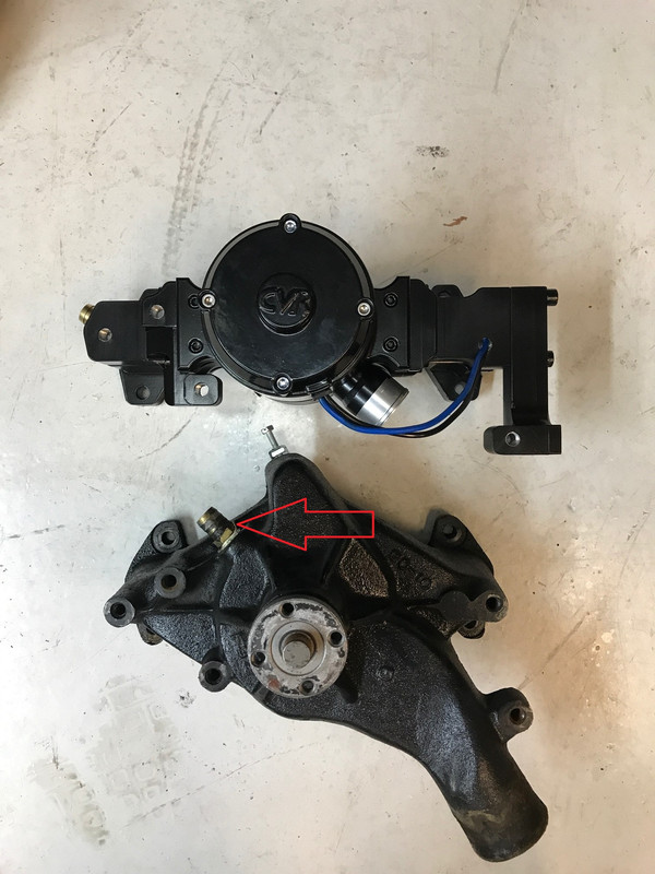

« Reply #6 on: January 03, 2019, 01:05:21 PM »
One thing to keep in mind for using the CVR pump on the street..... The pump does not have an outlet for the heater core like the stock pump does. If you want to maintain your heater you'll need to drill and tap Jay's adapter for a fitting. I like the idea of keeping the heater in-tact for street use in case something goes wrong and the car is overheating.

« Reply #7 on: January 03, 2019, 01:33:58 PM »
thanks a lot.
I didn't even consider that but I will need a heater.
Your pictures helped a lot.
Greg
