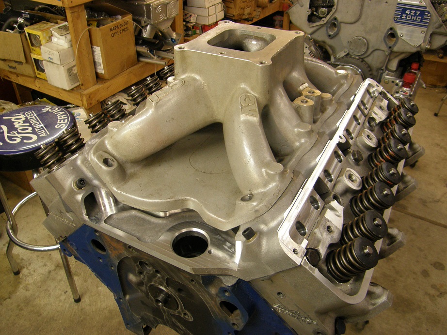

After I got this done, I put the CHI intake in place; here's a photo:
That manifold sure LOOKS like it ought to make power LOL!  The bolt holes in this intake line right up with the 351C intake bolt pattern already machined into the adapter, so there was no issue there.  However, the CHI intake manifold ports are a lot smaller than normal 351C 4V ports.  In order to see how they would line up, I cut a gasket to fit the manifold and then laid it on the adapter and traced the openings.  Here's a photo of the openings outlined with a black Sharpie on the adapter:
This intake adapter has not had any porting work done to it; the ports are as cast.  As you can see, there are going to be some parts of the cast openings which fall outside CHI manifold's port envelope.  This isn't the end of the world; you could certainly run the manifold with those openings there, because as they approach the FE port in the head the openings will get smaller and smaller, and eventually disappear just before the port reaches the FE cylinder head.  But if you were going all out with one of these intakes you'd probably want to fill those cast port openings with epoxy, or else weld them up, to make the transition to the FE port as smooth as possible.  Just something to think about if you want to run one of these intakes.
I'll be working on the machining programs for this intake over the next few weeks; it will take a while to get this done.  I'll also have to give the adapter a special part number for use with these intakes; using this adapter with a standard 351C 4V port would result in a very large port mismatch where the manifold bolted onto the adapter.  But, it still might work OK like that; one thing I have learned with all this intake manifold testing is that sometimes the engine just doesn't care about stuff like this...
