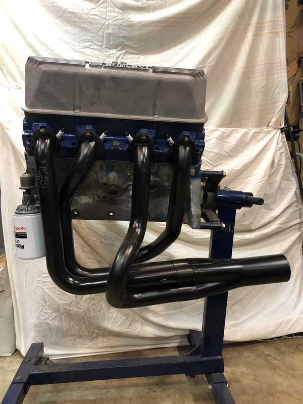

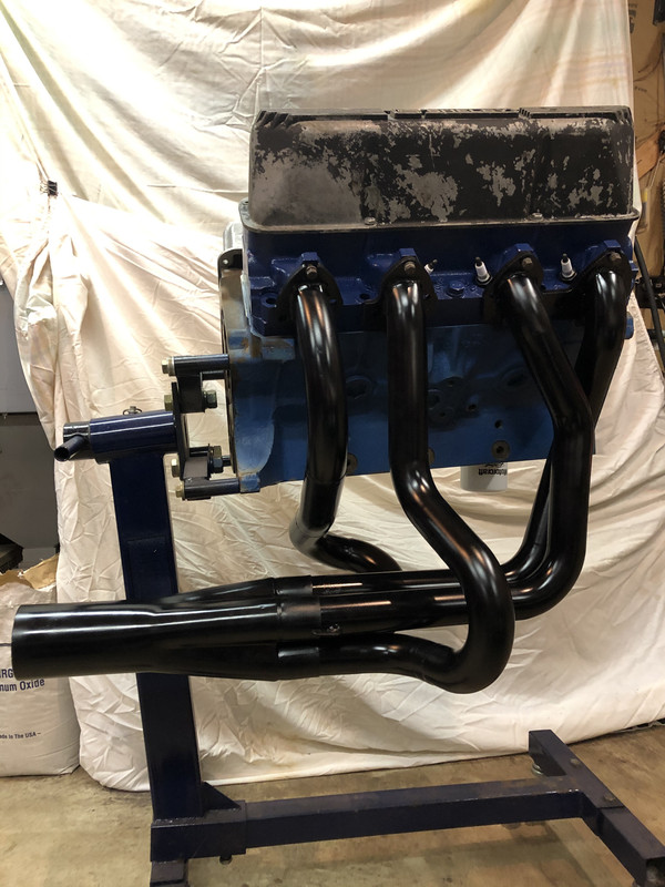

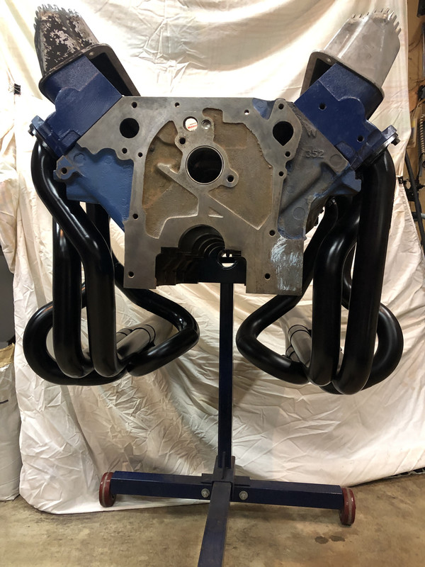

Here’s a set of Hooker #6376 adjustable race headers. These have the 2” primary tubes. They are similar to the larger tube #6375 Hookers. They have a 3 1/2” collector. I bought these used from a friend recently and abrasive blasted & painted them. I don’t know how old they are. Like the other Hooker FE race headers I don’t think Hooker makes these anymore. They did not come with the “adjustable” tube sections for the primaries, so they are on the shortest possibility. They are listed as fitting both the ‘67-‘70 FE Mustang/Cougar and the ‘66-‘69 FE Fairlane/Torino/Comet/Montego.
*Edited to add - when I first got these and I mocked these up I found one upper bolt hole on each side ( which are slotted ) didn’t line up exactly with the bolt holes in the heads. I tried another pair of heads to be sure, and same issue. It was a simple matter of a little work with the die grinder to clearance the header flange hole a bit more. A small issue, but with as much of a pain as FE headers in a shock tower car are, if I’d have been trying to install them in the car right out of the box it would have been a struggle, and likely tougher to figure out what wasn’t working. Mocking the headers up on a spare engine can be a big help. These headers have the 16 bolt pattern and the person who had these before wasn’t using the upper holes I needed for my heads, so they hadn’t run across the issue. Just an observation. I have run into this issue in the past on different set of headers, one bolt hole on the flange was just slightly off, but I found it ahead of time then also.
The #5 & #6 tubes clear the oil filter by about 1/2”.

Those snakes are cool Kevin. They would look smashing on a dummy engine in my shop.
Wanna sell them?
Wanna sell them?
Sorry, I bought these from my Buddy because I’m going to use them when we break-in & dyno test my 427 soon, then I may be using them in my ‘67 Cougar the 427 is going in.

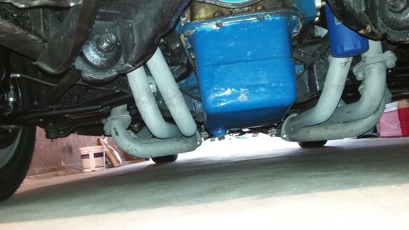

Dad and I both have a set of "Ed's". I wasn't fond of fitment with them. Seems like they hit just about everything possible, including physically touching the oil filter if you're running an FL-1A and the C1, C3, or C8 filter adapter. Clutch linkage clearance is "okay". Flanges were thin and so were the tubes. Mine were 1 3/4" primary and Dad's car currently has the 1 7/8". Both are Fairlanes '66&67. I have a couple pics of the old worn out headers on the old 390 that was in my car.
