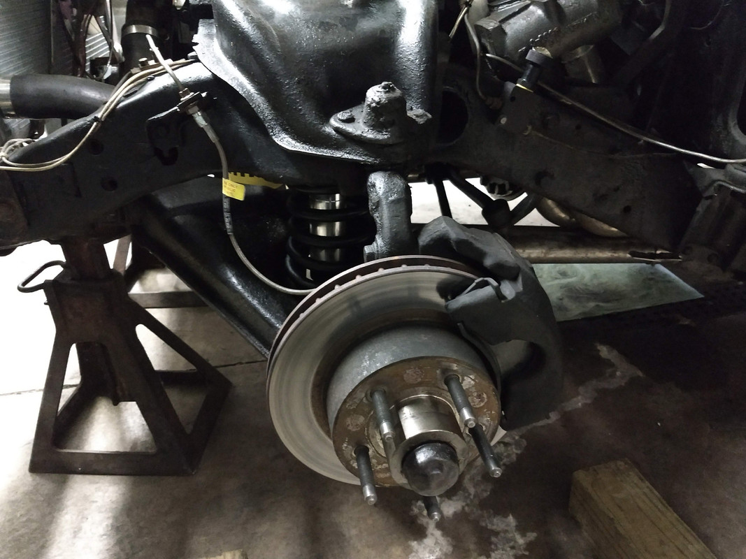

Existing T bird brakes with Hawk brake pads.  Worked pretty good actually.

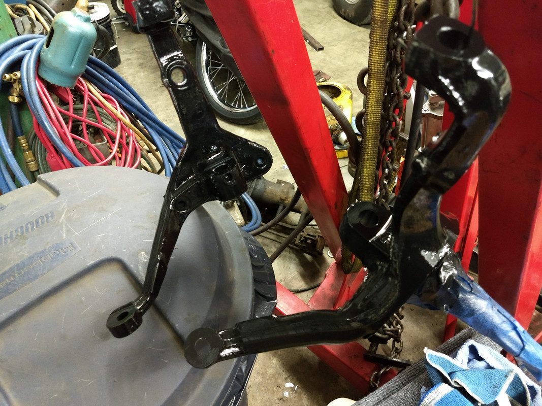

Thanks Chris for the spindles.   After a quick hot tank and bead blasting a coat of black paint made them look brand new again

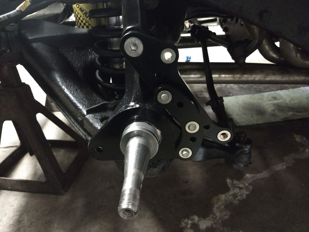

Brackets attached to spindles.  Fit really well, didn't have to shim them at all

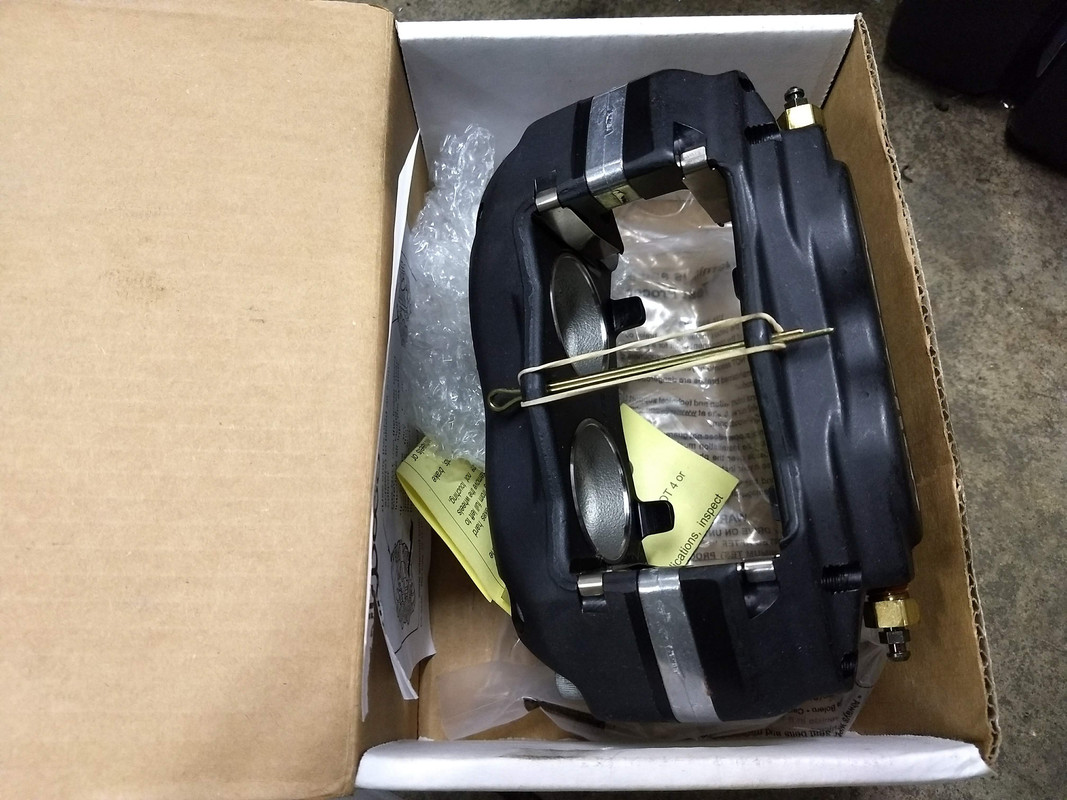

4 piston calipers

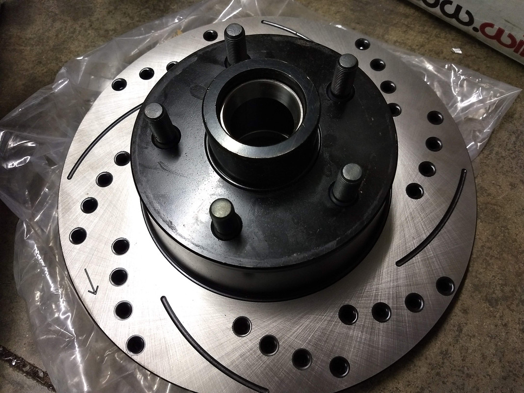

All steel rotors, drilled/slotted.  They are HEAVY!!!  Just like stock. This is not the dynalite model.

I may pull the rotors and install long studs to match what I had previously.
