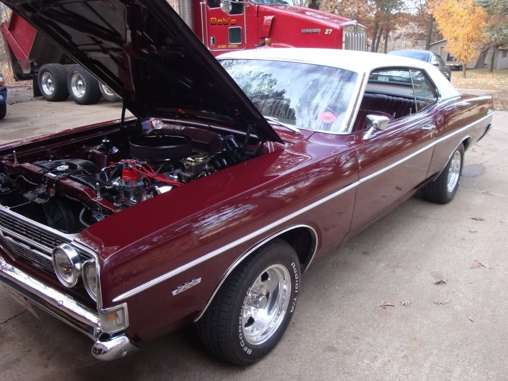

I have been working on jetting/carb tuning. It run's 90% right now. I have been having problems getting the choke set correctly. for some reason I cant get the high idle to engage. So Im taking that apart to figure it out. Also jetting up the secondary. I thought it was running real strong at wot untill I turned on the nitrous with the bottle off,so it would just get a fuel shot and WOW it gained like 50hp ! no kidding.  so I am buying some bigger jets today... and it has a little lean just off idle .. need to get the pump adjusted correctly ect ....
  Also need to pull the valve covers off when hot and adjust the rockers. There set at 20 cold and I'm sure hot there 26 or so.. thats to much .... Im going to set them at 15 hot.
