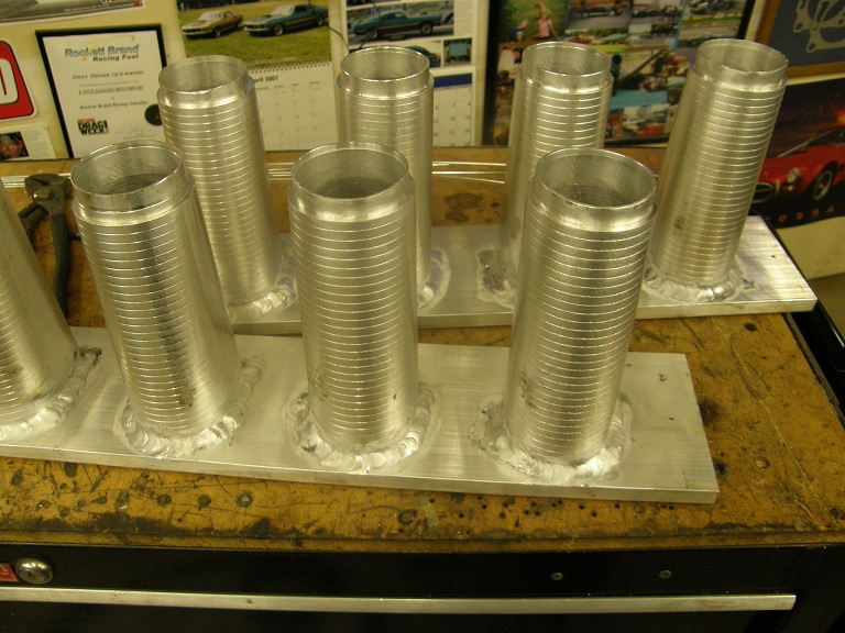

My knees were definitely rebelling at this idea, but it was better than not getting the welding done.  Thankfully, with the pre-heat and all the cleaning I did on the materials, the puddle formed nicely right away, and the welding went pretty well.  I was using my short-end torch so I could get in between the tubes fairly easily, but I still ended up dipping the tungsten in the puddle several times as I welded the first side of the intake.  Every time I did that I just changed out to a new tungsten and kept going.  I ended up having to weld both right and left handed to get to both sides of the tubes, and left handing the torch is a challenge for me, but in the end the first side came out pretty well.  Here's a photo of the welding on the plenum plates and the runners:
After finishing that side I put the manifold and jig back in the oven, and spent the next few minutes reballing the tungstens that I'd dipped in the puddle, and scotchbriting more welding rods.  I was using 4043 rod, and I'd used 3/16" rod on the first side, but I went through quite a bit of it, so I changed to 1/8" rod for the second side.  After dragging the manifold and jig out of the oven again, I flipped it around to do the other side.  This side went even better than the first, and I only screwed up the tungsten once while welding this side.
By now it was dinner time, so I went in to spend some time with the kids and let the manifold cool down a little.  An hour later I went back to the shop, and took the now cool manifold back apart, to set up the runners for welding the rest of the way.  Here's the runners and plates, disassembled on the bench:
I was going to get started finishing the welding on these, but I had more books to send out, so I reluctantly called it quits on the welding for the day.  Nevertheless, I was very pleased with how the welding went, and I'm confident that I'll get the basic manifold shape welded up during the evenings this coming week.  Next weekend I hope to get some more of the parts required for the intake CNC machined and welded together, so that next weekend it starts to look like a real intake.  I'll post another report next Sunday night.
