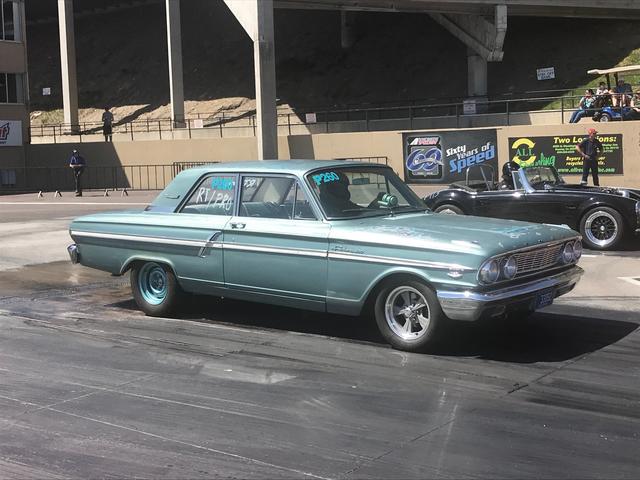

The other '64 we used to race wasn't a problem like this one is. It was a 482 FE, and actually about 1.5 seconds faster than this one is, but it was only running 3.91 rear gears. The 1-2 shift comes up a lot faster now, but everything beyond that is much slower.
Here's a couple pictures from this weekend. Green Comet is our friend Zack. He's a real solid driver. Got laddered up with him 2nd round which was kind of cool, but kind of stunk at the same time.
