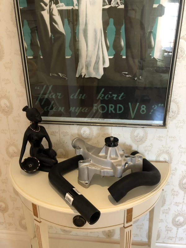

Got the new waterpump and radiatorhoses today, the
radiator is at the radiatorshop for a recore got a call yesterday
that i could come and get it so Monday or Tuesday i go and get it

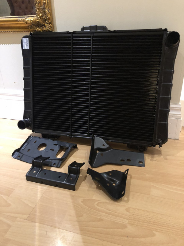

« Reply #28 on: April 15, 2019, 02:51:39 PM »
Got the re cored radiator today. Ouch how expensive a re core
is today, But i refuse to buy a Aluminium radiator. I also got some
brackets from the powdercoater......I dont know, i think they are
a bit to "flat" needs slight more shine compared to the undisturbed
stock paint under hood

Re: Cleanup winter project
« Reply #29 on: April 15, 2019, 07:46:00 PM »
I like the Swedish vintage Ford advertisement.
I've had to have a couple radiators recored where I work, out of necessity since no replacements were available. They were real expensive too. The guy who had the shop told me that cores are very expensive and hardly anyone does it anymore because buying a new imported part is cheaper. He's right, there used to be a radiator shop in nearly every town when I was growing up. Now this guys shop is the only one around for a long ways, and he's 4 towns away, about 40 miles.
