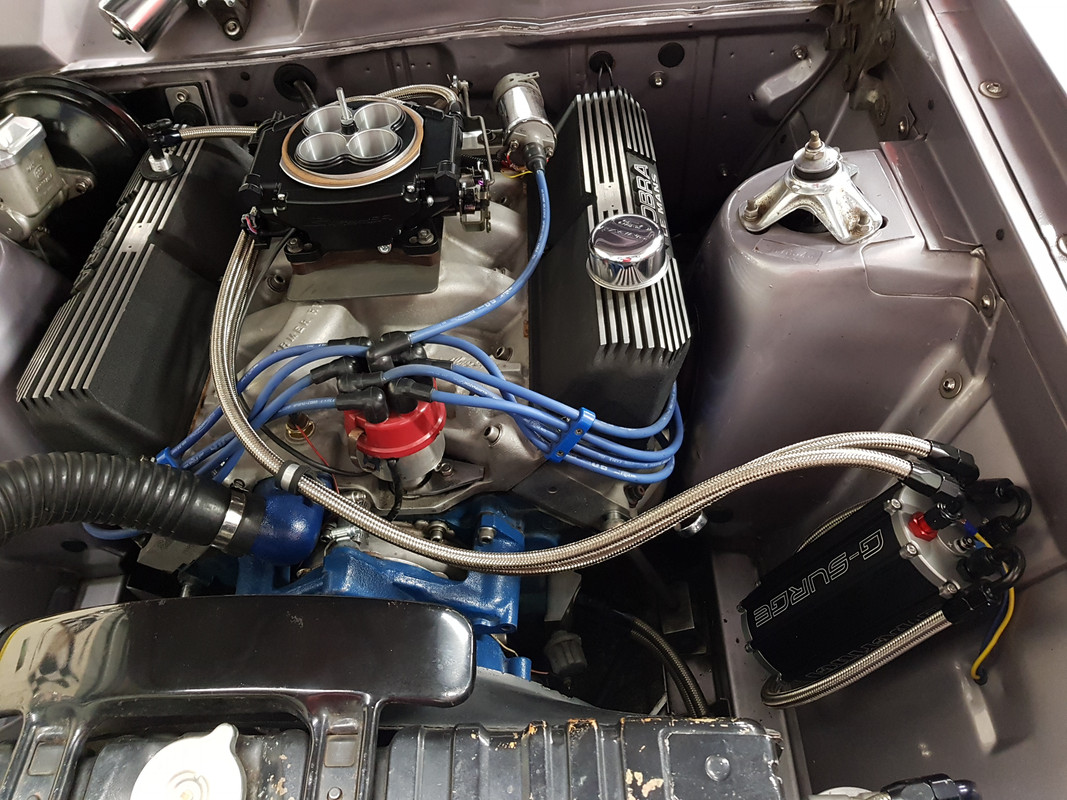

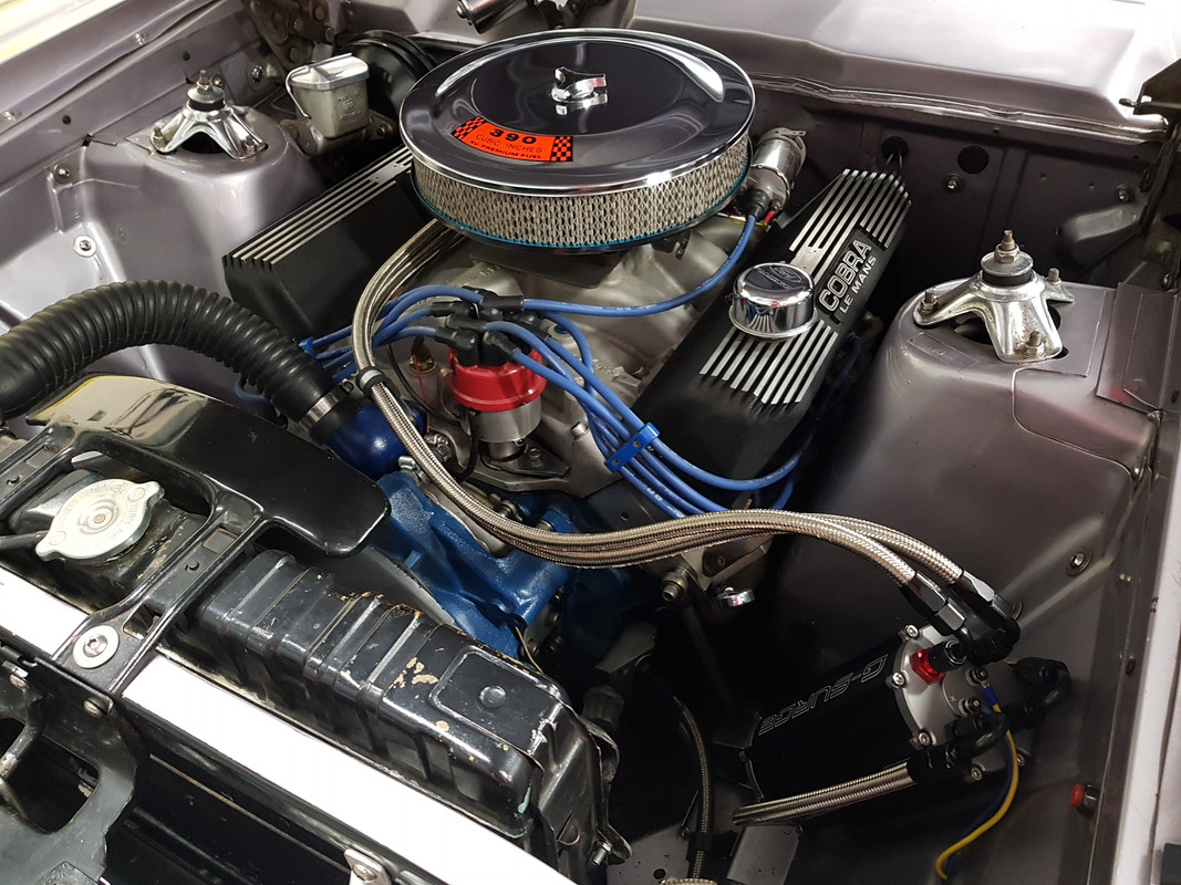

Here are a couple more pics with the install tidied up. Had to start the learn again as I had the battery off for a while during this. No big deal. This can be avoided in future as you can download your tune to an SD card on the HHC & then also store it on your PC or laptop. I have worked out how to do this now  ;D.
I put about another 30 miles on it & still really liking it. The plan is to let it 'finish' its learn then bring that tune into the PC & save it. Then on the PC I will experiment with different maps to try & lean cruise & implement decel fuel shut off & experiment with best hot start parameters.
Apart from the surge tank, with the air cleaner on you wouldn't know its there.

That sure looks clean and simple, maybe not as ideal as multiport setup but probably a bunch better than a carb. Easily reversible too is a nice benefit.
