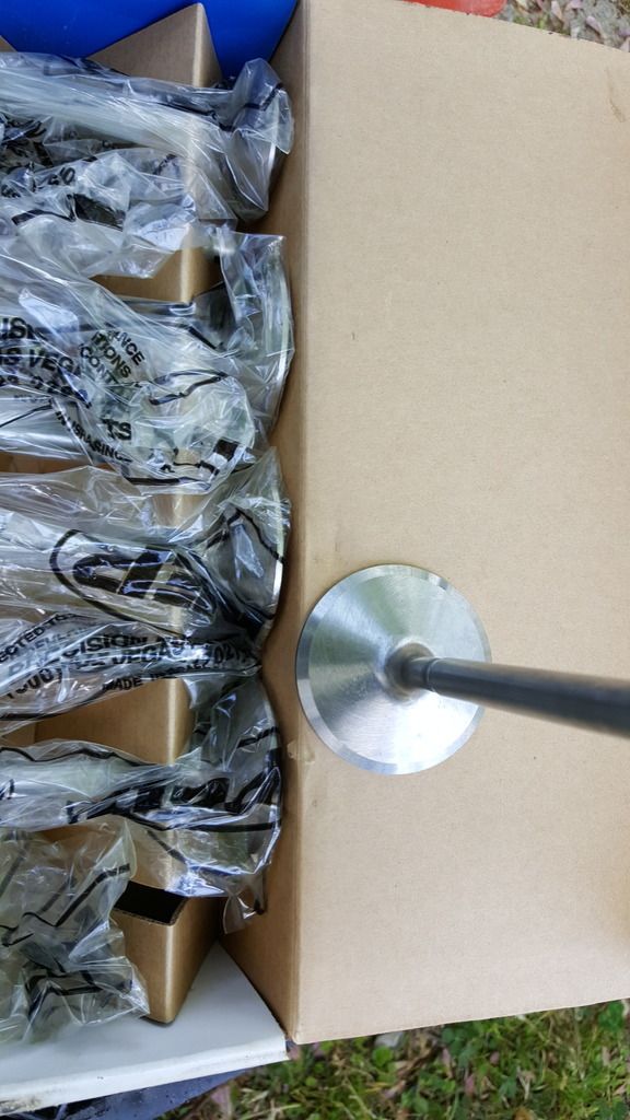

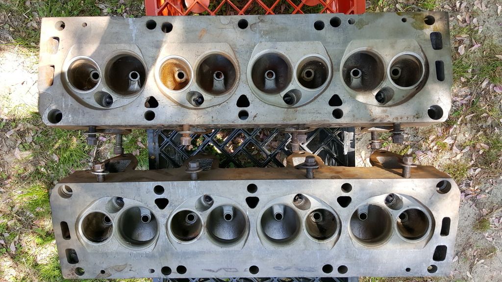

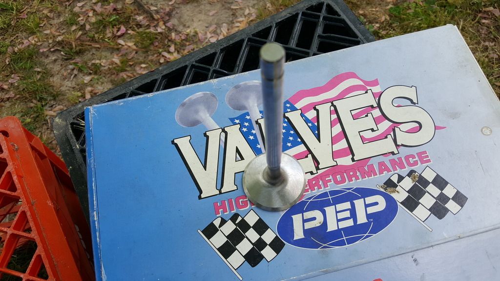

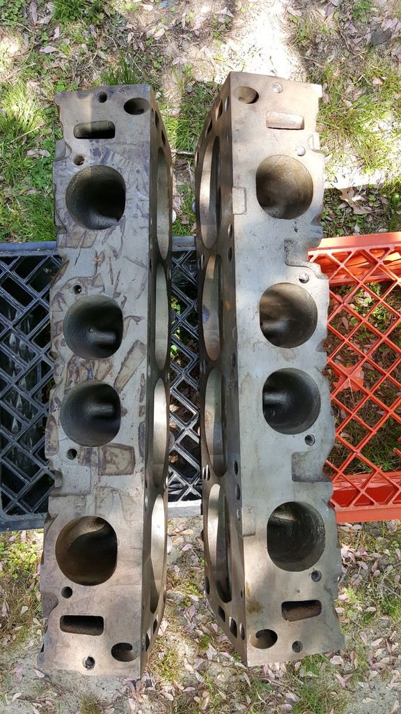

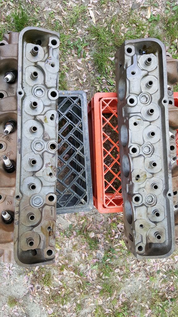

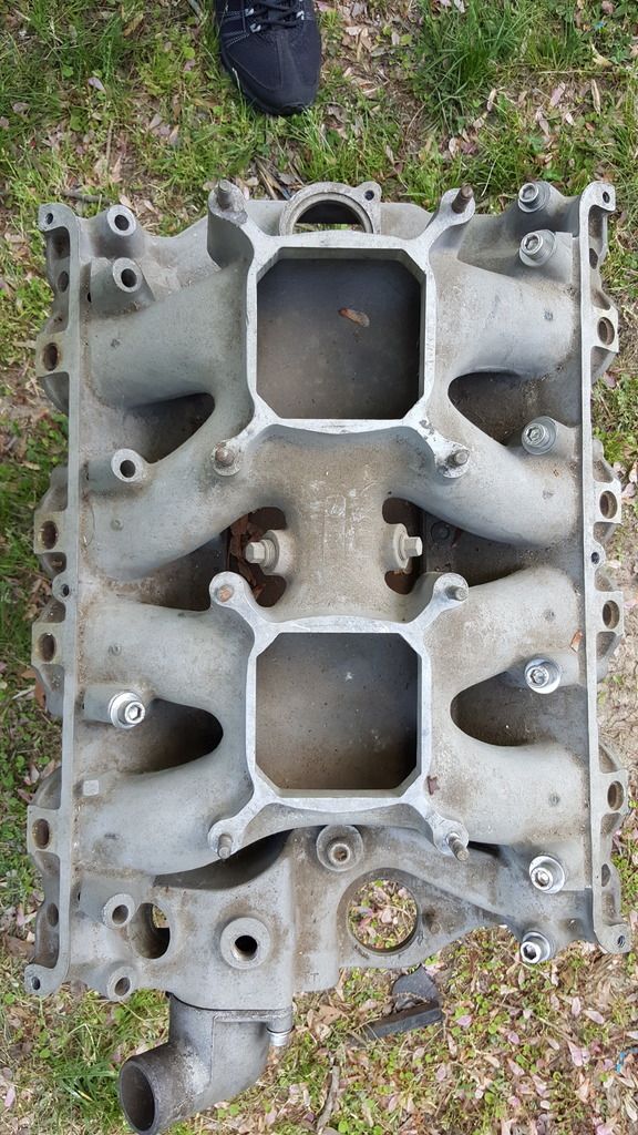

A few shots of the heads and intake.  Have all the spring cups and new valves as well. All been setting since 2008
Re: Iron tunnel port heads, what to do ??
« Reply #14 on: April 17, 2017, 05:22:41 PM »
I see the one head has the common welded up area between the spark plug hole and the intake seat.  Very common to see the tunnel port heads crack there.  Fortunately there's no water there; I've heard of people running them cracked for long periods...
