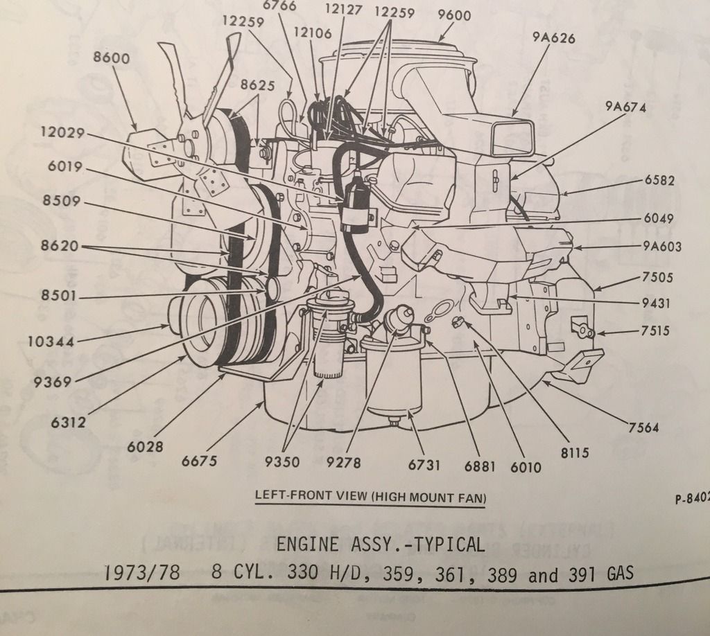

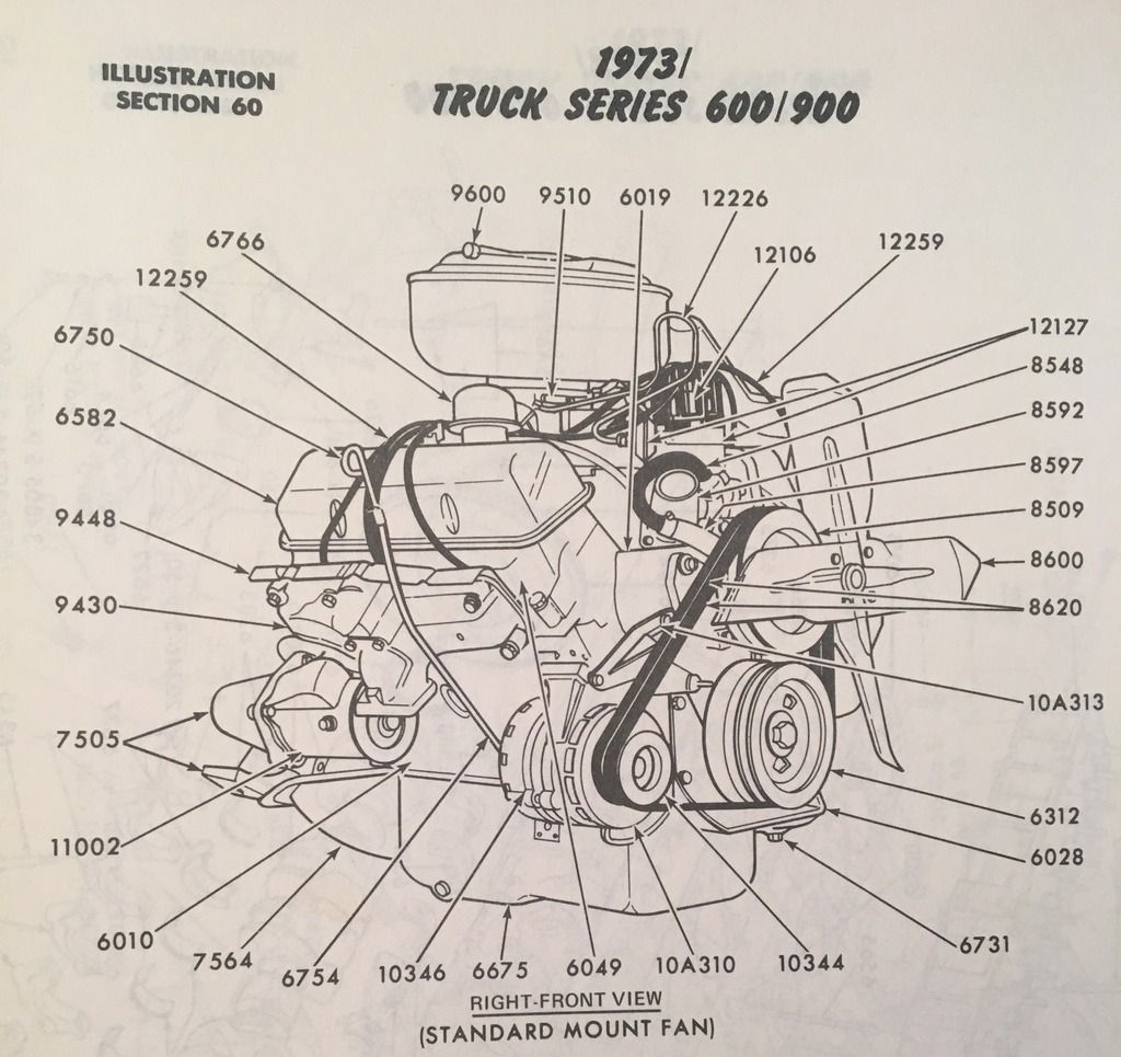

FT engines can be a bit confusing. I think a better way of categorizing them is by which type of vehicle they were intended for, which is how Ford did it. FE engines were used in the F100 to F350 series light duty trucks, FT engines were used in all the series above that, which includes medium and heavy duty trucks, some examples being the F600, B500, N500, and many more. I point that out because the 330 was made in both a 330 M/D ( medium duty ) and 330 H/D ( heavy duty ), the 330 M/D shares FE crank snout dimension and some of the front dress items, and I think maybe distributor size. Many of the other FT engines could be configured different ways depending on the type of vehicle they were going in or fleet order customer ( like U-Haul, UPS, etc. ). Here are a couple FT engine illustrations from the Ford Truck Parts book, along with displacements, just for info purposes. You'll notice Ford showed both a "High Mount Fan" and "Standard Mount Fan" types.

There was no 360 FT that must be a mistake/typo.
The 359 and 389 were indeed FT engines in the late '70's and IIRC each one was used for only one model year.  They are special configurations that Ford created in order to win big fleet contracts (U-Haul, etc.).  The 359 is the same bore/stroke as the 360 & 361 and the 389 is the same bore/stroke as the 390 & 391.  Ford just gave them a one CI lower size designation to differentiate them from the other engines.
In addition to the 330MD and 330HD mentioned above the 330 FT was also available in the "330XD" configuration for the 1979 U-Haul trucks.  It is widely published that the '78 model year was the last year for FT production but the U-Haul 330 XD's were produced well into 1979.
FT blocks are also different from FE blocks in that they all have an NPT hole in the passenger side skirt just above the pan rail near the #2 main.  It was used as an oil return port from the air compressor on the bigger trucks equipped with air brakes.  Pic attached.
I'll see if I can dig up some more documentation to add to what Kevin already provided on these oddball FT engines.
