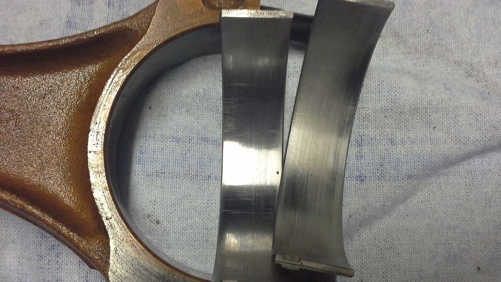

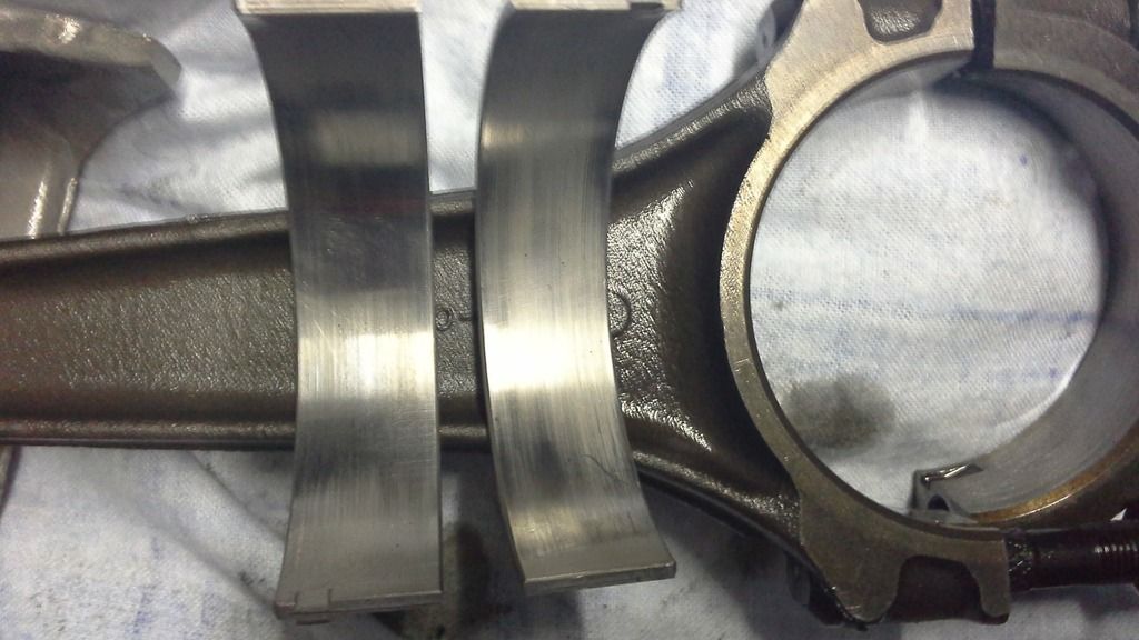

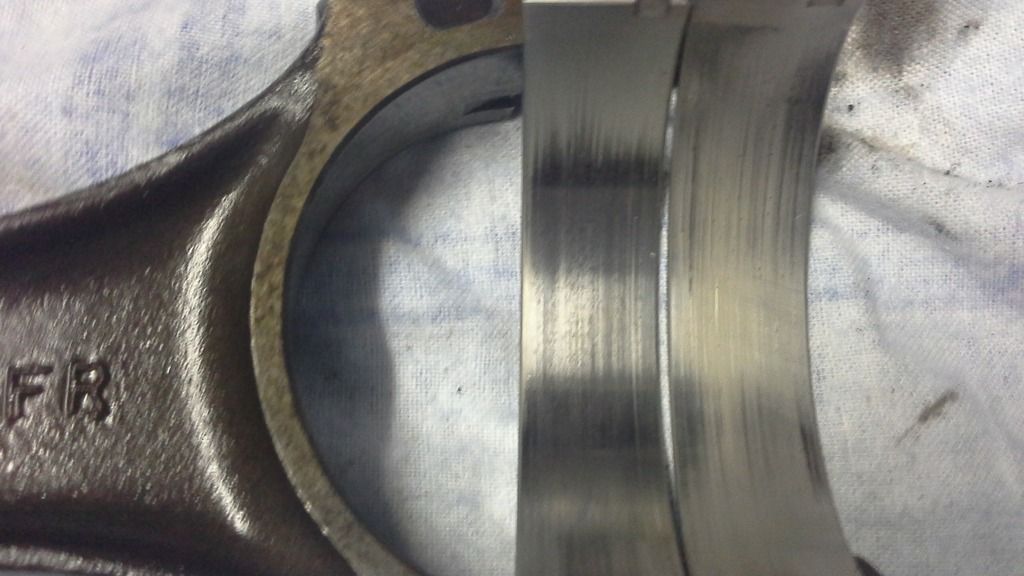

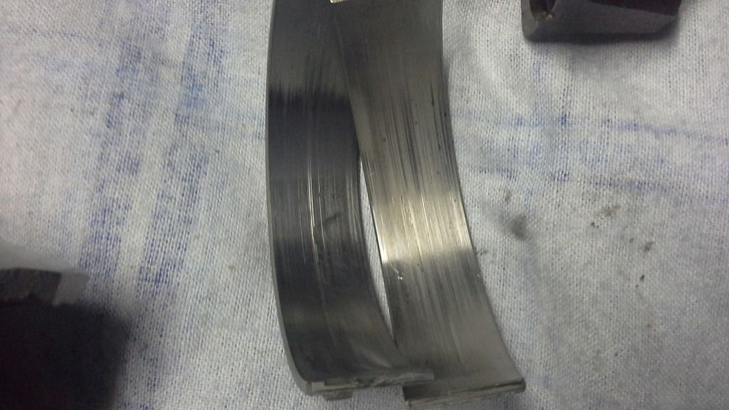

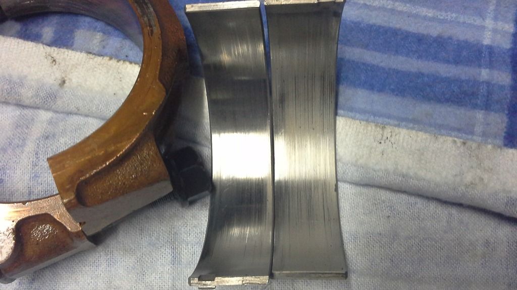

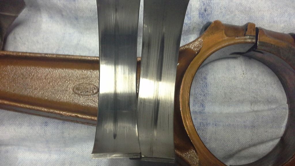

« Reply #7 on: October 11, 2016, 04:10:28 AM »

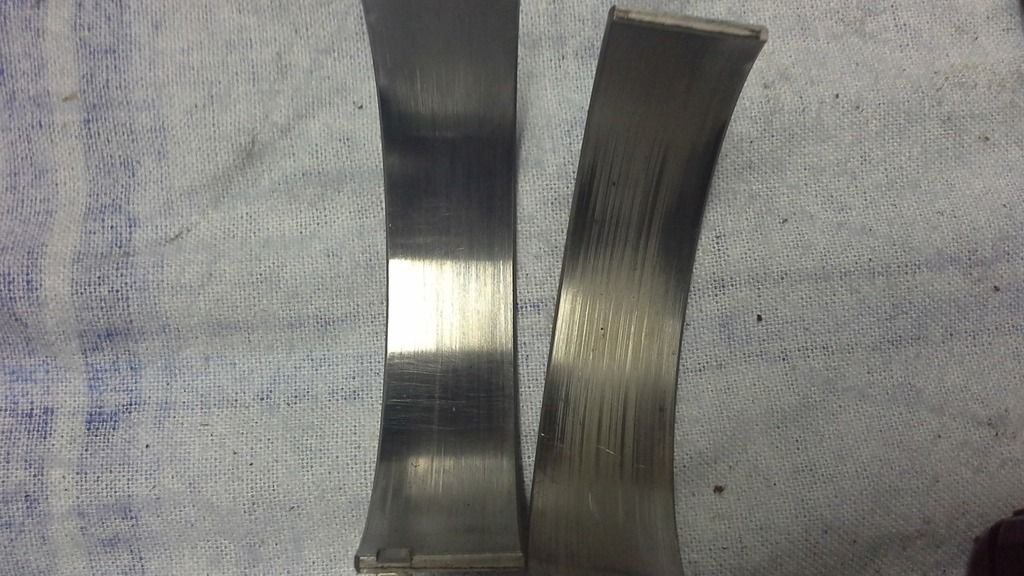

Ok, I have the images - hopefully you can see them ok here. Straight out of photobucket.
EDIT :: oops forgot the rod markings - not all rods have markings and some are copper coloured...what's that about??!
Left bearing in each image is the top shell (closest to rod end) and right was in the lower shell - all in order here from #1 to #8.

Re: Balanced assembly installed in Incorrect Order
« Reply #8 on: October 11, 2016, 07:39:10 AM »
So, #2 and #6 are the ones with excessive wear?  Hard to tell for sure in the pictures, and none of them look all that bad (not scored down to the copper or anything).  With all the scoring on the bearings it looks to me like there was a bunch of trash in the motor when it was assembled, kind of like the oil passages weren't properly cleaned out prior to assembly, or there was some trash in the oil pump, something like that.
That has nothing to do with the vibration issue, of course.  The rods are all marked with a number?  And the #1 rod is in the #1 cylinder, #2 rod in the #2 cylinder, etc.?  How about the position of the markings, were they to the outside of the engine for each rod?  Just trying to confirm that the pistons and rods were assembled correctly...
« Reply #9 on: October 11, 2016, 08:49:21 AM »
I'm with jay on the dirt in the engine. Especially that bearing
that's scored where the oil hole is in the crank
Check my build tread, what you can find in a used
oil pickup whe you take it apart
Then you have some not uniform wear pattern on some
bearings. Is the conrods round and straight or was there
some dirt under the bearing when they assembled the engine
But nothing of that explains the vibrations

  • Posts: 4608
« Reply #10 on: October 11, 2016, 09:38:43 AM »
I'd also agree about dirt being the culprit for the majority of the bearing wear, and that they don't look all that bad otherwise.
The vibration issue could be many things; a bad harmonic balancer, a miss or uneven cylinder loading, a bad/mismatched or out of balance flywheel/flexplate, a bad motor mount or transmission mount or just bad tuning for idle. Obviously you'd want to eliminate the flywheel being bad or cracked and that the balancer coincided with TDC, because those can cause serious and bad issues. And don't overlook the possibility of the WRONG flywheel/flexplate, because 428's and 410's used an offset balance on them, and if this wasn't determined before and during the balance job, a bad vibration would be the result. As for a bad balance job, that can only be determined by a rebalance.

Thanks for the feedback - you know, I have a gut feeling too the block was not cleaned out properly when it was machined twice. I have the invoice from the machine shop but it does not say anything about being washed & cleaned when I just checked - my fault.  The guy before that I doubt if he did anything at all and I could not get an invoice or anything out of him.
Assembly was possibly incorrect as well based on previous history. For example the first guy did not use rod protectors on the bolts and EVERY crank bearing surface had to be linished due to large scratches and bumps!
Ok - better go to plan C now, I am over this!
« Reply #14 on: October 11, 2016, 07:26:38 PM »
The copper-colored rod is a factory fix to correct a slightly oversized bore in either end.  Rods that checked oversize on the line were sent in batches to be plated, then re-machined to spec.
This isn't a bad thing, so don't worry about it.  The discrepancy would have been very small - tenths of a thousandth.
