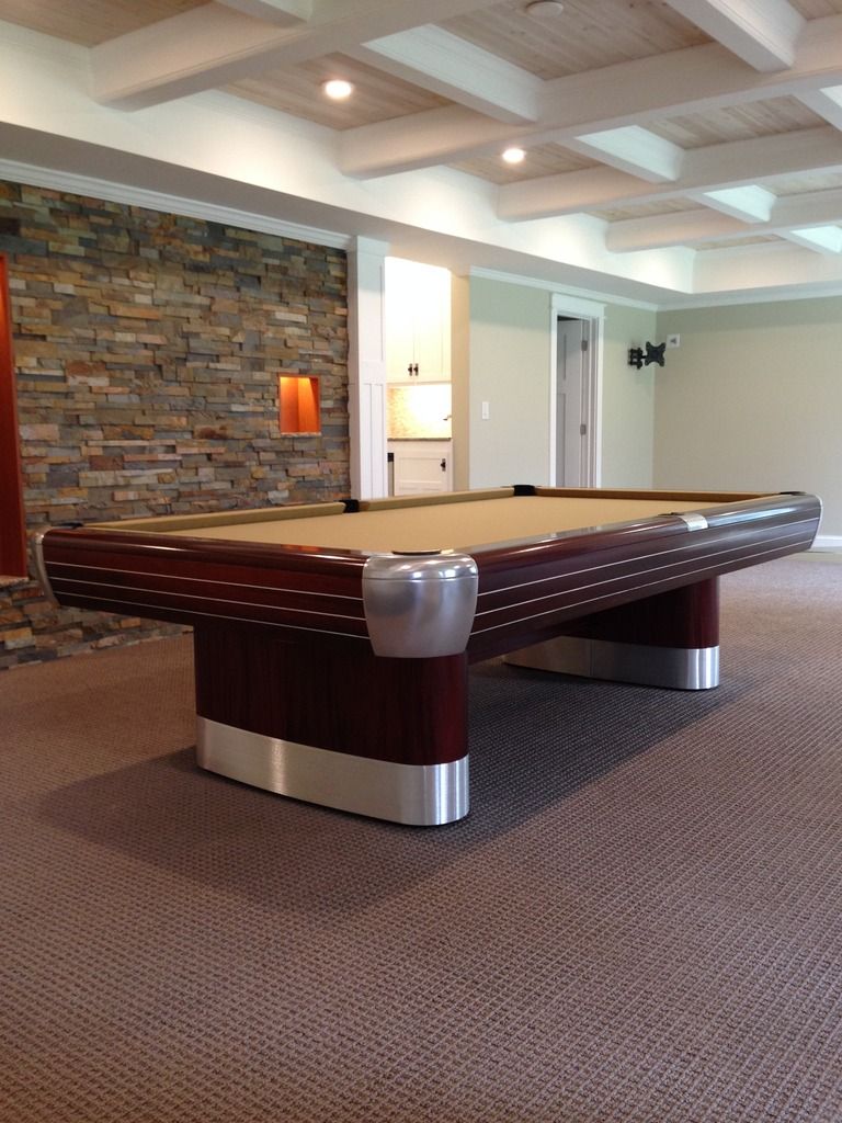

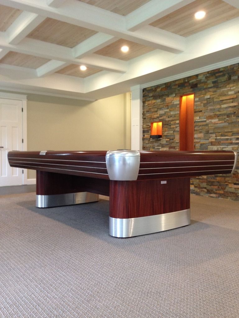

The desire for this project came from my recent completion of finishing my basement. I don't want a complete "man-cave" theme, but I do want it to be fun and semi-whimsical (is that word too soft for an engine forum?). The idea is to project some of the personality of the family but still have everything tie together. One thing I've always wanted but never had enough room to do right is a pool table. So, with the table I wanted in mind (1950's Brunswick Anniversary), I designed the layout and busted my ass for a few months. Did everything myself except lay the carpet. Next, I found the table I wanted at the right price and got it set up. This table has cast aluminum pockets and unique pedestal feet with aluminum skirts, so it really blends well with older automotive stuff. Probably the reason I'm drawn to it.
Here are a couple shots of the room and the pool table. The coffee table will be at the far end with a group of swivel chairs.

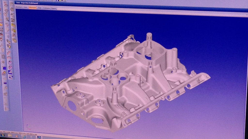

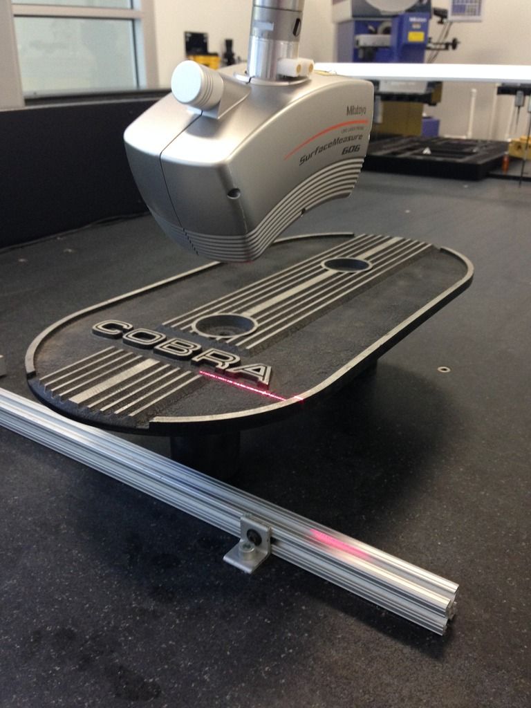

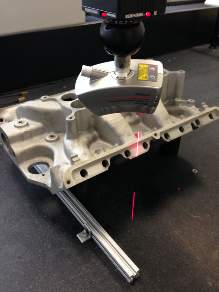

Parts being scanned using a Mitutoyo line laser scanning head on a Mitutoyo CMM. I'm evaluating the line scanner as a cheaper alternative to a structured light unit for work (reverse engineering and tooling development). These parts actually worked out very well for the evaluation because of the geometries involved. The intake was very complex and required 100 scans to get a decent file. I still have some work to do in some editing software to clean it up and reduce the size. The original file included about 25 million points. It's currently down to 9 million and will be reduced considerable from here.
The lid was a good speed challenge for scanning, considering the nearly 2 dimensional geometry.

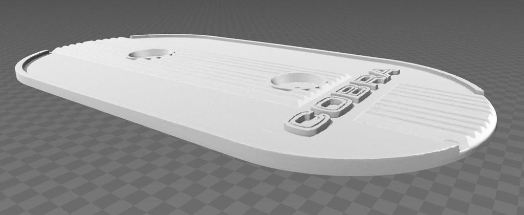

Model of the lid is nearly done. The bottom is flat, not contoured like the original piece. This will enable printing, was easier to scan and won't be noticeable when assembled.
Here is the model evolving for the intake. This was also only scanned from the top. The underside will be filled manually in the software. No care was taken to scan the head mating surfaces other than the front and back that will be visible. This is currently just a shell of the top surfaces of the manifold.
You can see some of the areas that need to be manually cleaned up. I'm doing that now. Originally, I was going to leave the model as a top shell only to keep the material content down. After considering the fact that some surfaces will have no support to start from as its being printed, I've changed the plan. The underside will be completely filled and then the printing parameters will be adjusted to print the interior in a substantially lighter structure than the external few mm.
