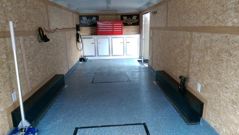

Here's a picture of the one I bought. 24', pretty basic except for a few nice amenities like lower cabinets, insulated, interior paneling, 120 volt package (includes lights and outlets, 30 amp breaker box) and 2 spare tire wells, V nose, stone guard on front, tread plate on ramp door.
Here's how I mounted the winch. A few pieces from the local Tractor Supply store put me in business. Cheapest price on the winch was from Amazon and it works great.
This is what it looks like after epoxy coating the floor, adding the center D ring and winch assy. and adding a cheap Harbor Freight tool chest on top of the cabinets. It's about the perfect size for me and what I'd haul. Gives me space to sit and relax with the car in there, but that's about it.
I'll add a few more useful items, but not a lot. These things seem pretty basic to me for something I'd want to use for spending a weekend in at a racetrack. A bit much probably for just a car hauler.
