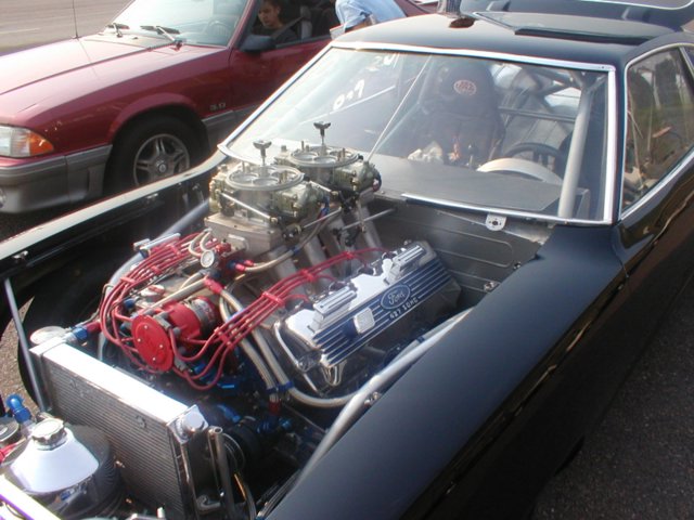

I have also seen other sheet metal intakes for SOHC engines with runner lengths that seemed to vary quite a bit.  The first photo below shows a picture of the sheet metal intake on Mike Jackson's SOHC race car, and the runners appear to be in the 6" range.  The second photo shows a tunnel ram intake with much longer runners:
After last week where at the machine shop another intake measured a total runner length of about 11", and this manifold was tuned for 7500 RPM, I really didn't know where to be for runner length.  Bottom line was that I wanted to make an adjustable intake, where I could vary the length of the runner from about 10" to about 14", and get dyno data for each combination, in order to pick the best combination for the engine.

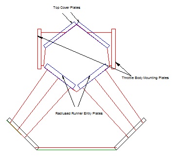

The design I came up with looks more like a conventional sheet metal intake, and still allows plates on top of the runners inside the plenum to lengthen the runners for test purposes.  The drawing below shows the basic idea:

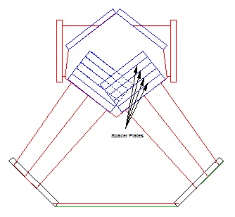

With this design and no extensions on the runners, the plenum volume is just about right (585 cubic inches), and the total runner length is about 10".  The throttle bodies are mounted on the side of the manifold due to constraints in the vehicle.  Adding four 1/2" extensions to the runners would make the manifold look like what is shown in the drawing below:

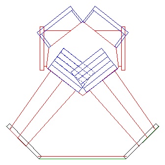

Runner length is now 12", and the runners are starting to take up some room in the plenum.  Further, there is only a couple inches of plenum area over the runners, which is a concern.  So, adding spacers to the flat plates at the top of the manifold will restore some room over the top of the runners, and add plenum volume, as shown in the drawing below:
This manifold is obviously not the ideal design, but it will allow me to test runner lengths and plenum volumes on this engine.  If it works pretty well I will probably just use it on the car and if not hopefully it will point me in the direction of a better design that I can build, perhaps later in the summer.
