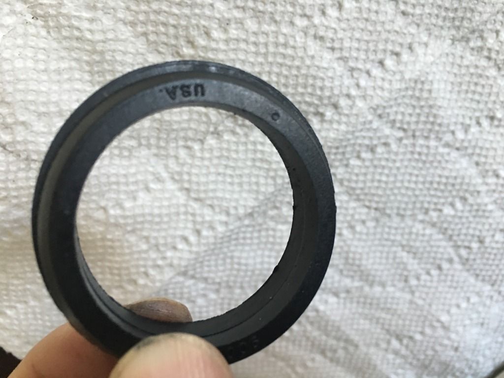

I'm rolling the dice on the rear main seal Brent. I had two small drips after the cam break-in and some initial running. I took off the flywheel and saw a very small wet area at the base of the seal. I put it back together and went thru my carb tuning and no leaks (so far).
It may be foolish on my part but we are gonna put it in and hope for the best. I need to get the car out of my friends shop for a while to make way for other work and I'm not bringing it back without the engine in it (the front cap is still here with the engine).
