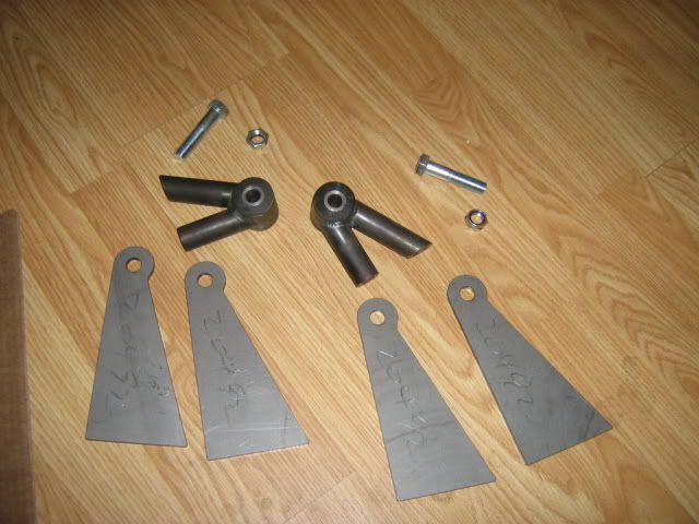

I have a 1964 Ford Falcon Sprint with a 408 stroker motor already in it. I also have a 427Fe motor built using Barry's stoker kit with 10:6 compression with 482ci. I plan to remove the 408 and put in the 482. Here are some pictures.
Anyway the shock towers are gone and the car has a heidts mustang two front end and heidts 4 link with coilovers. What size double pumper carb would be good. What non vacumn distributor would be good. Do I have room for a electric water pump or should I go to an aluminum one? I do have a built c-6 already and what about headers? So any opinions, ideas, suggestions or other advice would be greatly appreciated.

a friend did a 64 Falcon with a 390,, and couldn't find headers that fit his car, even though it was an automatic, so he found a set of BBC shorties and had to modify one tube each side.. after that he said they fit good.
for motor mount, I made my own motor plate for my 62, and a motor mount kit from welder series and welded that up to my plate after I set the motor where I wanted.
