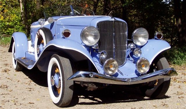

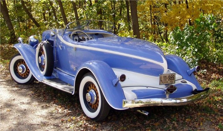

Hemi Joel
  • Posts: 502
Re: Amazing: even Pontiac has a new/old all-aluminum engine!
« Reply #7 on: March 05, 2012, 10:35:58 PM »
Sadly, Joel was forced to sell his Auburn Boattail Speedster so that he could afford to buy his Duesenberg  :D
Ahhh, the Auburn... a 1933 Salon Speedster. That was hard to part with, it is such a beauty!
« Last Edit: March 05, 2012, 10:37:35 PM by Hemi Joel »
« Reply #8 on: March 05, 2012, 10:53:04 PM »
That is a beautiful car, all right.  But it needs an FE  ;D
