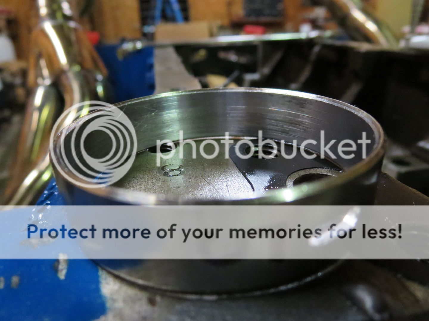

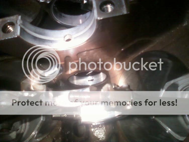

After shutting the engine down I cut the oil filter open and to my horror I found fine metal shavings... a lot of them.  The engine probably had 1 hour of run time with only the outer valve springs and dampers installed.  Upon disassembly, I fear I have made a critical error.  See the picture below.  Have I installed the cam bearings up side down?!!
Of course I'm ordering new bearings as the old bearings are toast.  Should I just replace, clean and reassemble?  Could upside down bearings really do this?  What would you do?

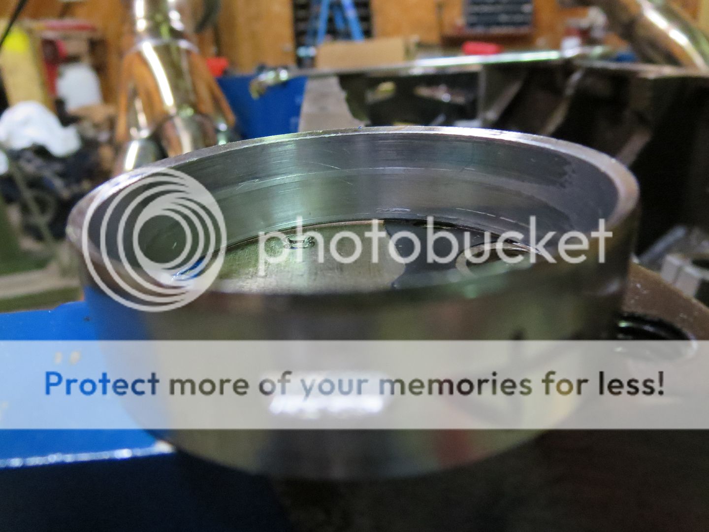

OK, here are pictures of the bearings removed.  #1 bearing looked the best since it was installed correctly, #2 thru #5 looked pretty rough although some more than others - all (4) of these bearings were installed incorrectly with the oil hole at 12:00.
**Edit - Added photos instead of link**
