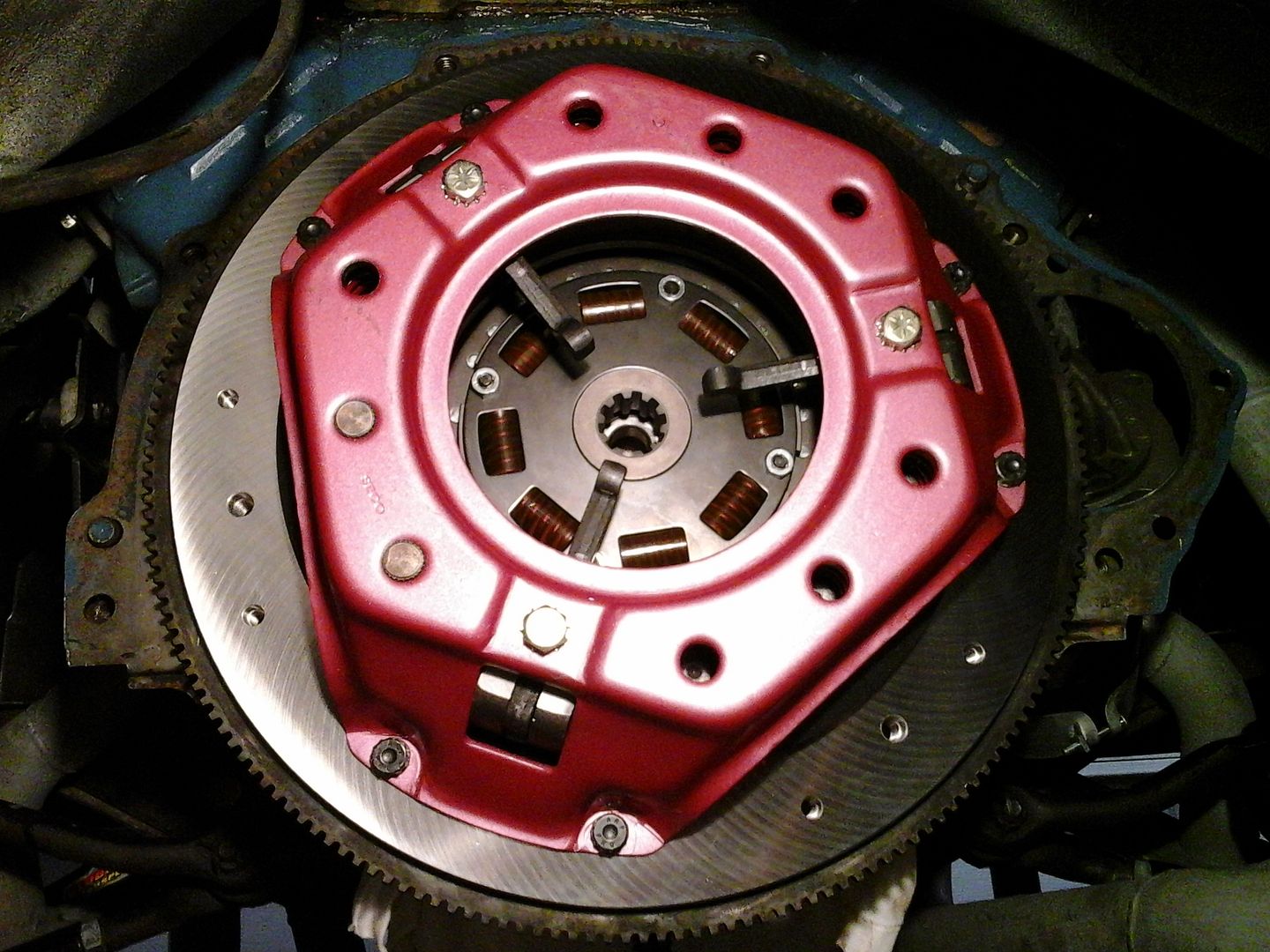

I bought the Ford Racing billet steel flywheel for mine along with the Ram street/strip dual friction clutch kit rated to 550hp. After I installed the new setup last fall, I pushed on the clutch pedal and felt a bad vibration. I tried to go around the block and it chattered worse than the factory hd unit I fried before. I took it back apart and found that all three fingers on the pressure plate were uneven. Called Summit Racing, sent it back, got a replacement, checked this one before final assy., put it back together and took it around the block this spring. Much better. I will hopefully get a few more miles on it in a week or two, and then drive it to the track to see how it runs.
