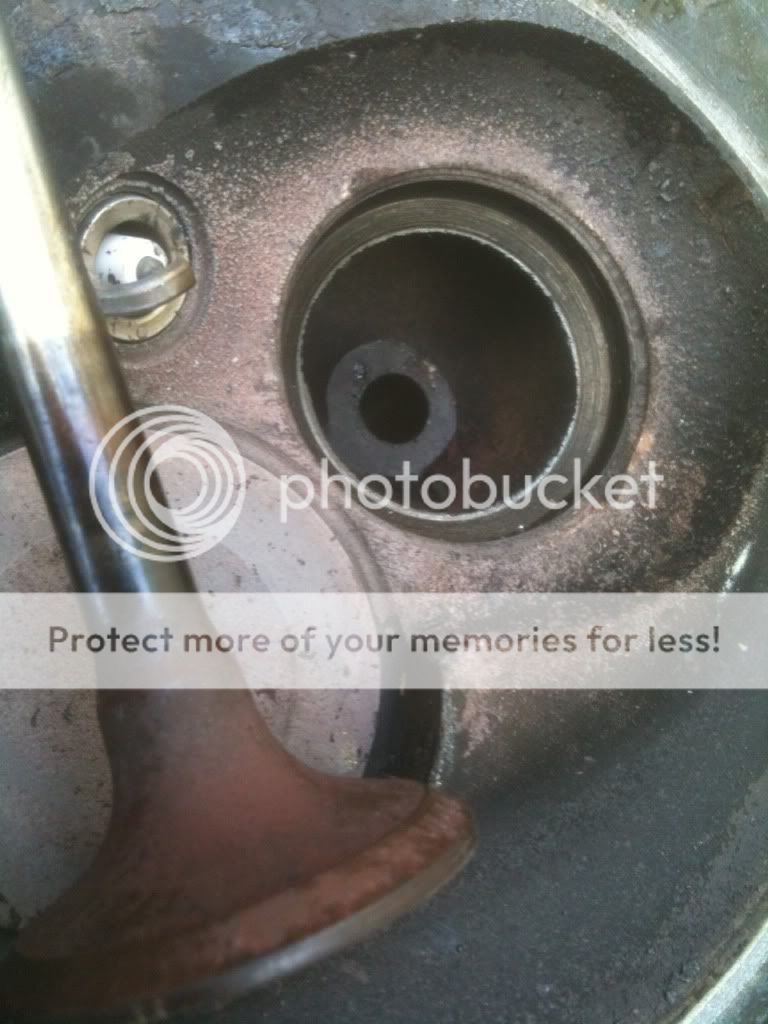

Ask and ye shall receive!
The valve looks surprisingly good, though it clearly was only acting as a loose plug for a long time.
BTW I just finished installing the new heads yesterday.  The truck is all buttoned up and runs sweet  :)
To aarons428 - The original head bolts went back on just fine and felt good torquing up to spec.  Make sure you have a good T-55 1/2" drive Torx tool for these, because they need quite a bit of Ooomph.

Sheesh!  Kiss the first .200" of lift goodbye LOL!
Re: I've never seen such a thing on a light-duty modern truck
« Reply #9 on: February 19, 2012, 11:12:35 AM »
Good pic. Amazing too as it almost looks like it was made that way! Usually one side of the seat or valve is burned up but not in this case. Odd indeed.

Yeah I'm very surprised.  It almost looks like a freshly machined pocket for a new valve seat.
You can't see it in the pic, but the short side of the port is razor thin under the seat.  The lifter just ran out of lash adjustment before the thing could sink any more!
I just measured it.  .270"  :o  That's over half the lift!
