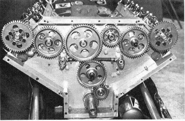

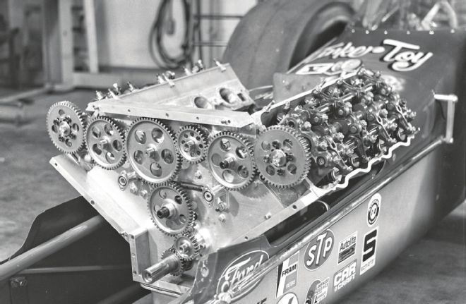

"Sneaky Pete" was a pretty sharp guy, that's for sure. Here are a couple larger examples.

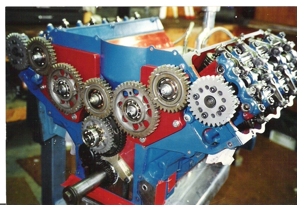

So yours will have bearings like this one? And helical of course.
Autoholic
  • Posts: 423
Re: SOHC Gear Drive
« Reply #5 on: July 29, 2015, 07:34:15 PM »
Pretty much, but my design reverses the direction of one of the cams. This should make the two banks equal, as Pete noted there were issues with heat and detonation. I look forward to reading the rest of the article to find out what Pete was able to solve. The gear drive that replaces the short chain in that pic is actually a production part and is the basis for what I have done so far. I believe that by adding another idle gear here will help deal with torque transfer as well as serving as a fail safe. It may be overkill but then again, some would say a gear drive by nature is overkill. I see it as a way of bullet proofing a $40-50k engine. Only thing I'd worry a little bit about is trying to get some oil splashed around on the gears, I don't know how much oil spray actually makes it up front. I would opt for permanently lubricated and sealed ball bearings, instead of open ones. Then I don't need to worry about the oil lubricating the bearings, just helping decrease friction in the gears rubbing together. Oh and one more reason for double helical over spur is quieter operation, however hearing a gear drive over the sound of 7 litres of American V8 with side pipes is pretty hard.

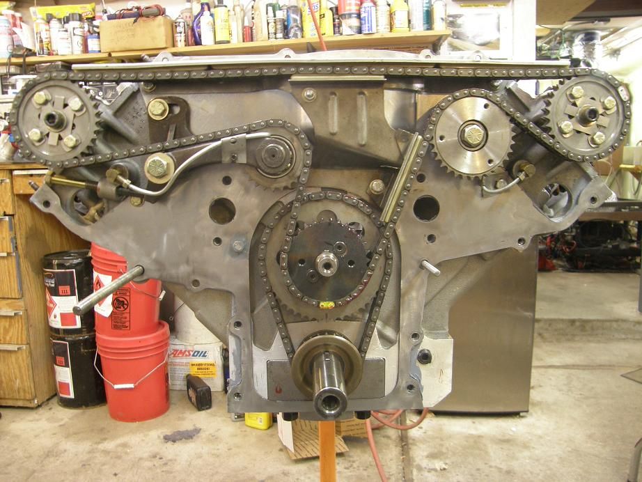

I can share a little bit of info on this.  First of all, the original Ford cams, and the newest Comp Cams, have slightly different lobe profiles for the left and right cams.  This was to address the differences in the valve train geometry from side to side, so that the valve action was identical on both sides of the engine.  Barry at Survival and I worked with Billy Godbold at Comp Cams to get this done a few years ago.  Back in the day, when Crane was doing SOHC cams, they made them the same side to side, which led to the problems already mentioned, so that's why Pete Robinson's gear drive reverses the direction of the right cam.  Nobody racing these engines back then was running stock cams, of course.  Reversing the direction of one of the cams is not necessary if you are running factory Ford cams, or the latest Comp profiles (Comp 8500 series).
On the chain stretch thing, I did extensive experiments on that back in about 2006, using magnetic sensors on the crank and both cams to see how the cam phasing with respect to the crank changed at various engine speeds.  On that engine, from 3000-7000 RPM, I found that the right cam retarded about 3 degrees, but the left cam actually advanced a couple of degrees.  This was not an expected result, of course, but it was repeatable on that engine.
Fast forward to one year ago, when I upgraded to the MS3X EFI system on my big SOHC.  This EFI system has provisions for an engine with variable valve timing, so it has inputs for multiple cam sensors.  So, since I needed a crank and cam sensor anyway to run full sequential EFI, I added a second cam sensor on the second cam, and logged the data.  I was surprised to find that this engine behaved quite a bit differently than the engine I built in 2006.  Rather than having the right cam retard and the left cam advance from 3000-7000 RPM, I found both cams retarding, the right cam by about 7 degrees, and the left cam by about 4 degrees.  Also, in my testing in 2006 I was not able to get data from idle to 3000 RPM, but with the MS3X I could do that.  I was again very surprised to see that both cams retarded another 3-4 degrees between idle and 3000 RPM!  Basically I got a total of about 10-11 degrees of retard on the right cam, and 7-8 degrees of retard on the left cam.
The difference on this engine, compared to the one I did in 2006, was a much more radical cam profile, and much heavier valvesprings, something like 280 on the seat and 660 open for this engine.  The engine in 2006 had much less pressure, if I recall correctly around 170 on the seat and 450 open.  I think this is probably the reason for the different results.
On the current engine I ended up degreeing the right cam at about 104, and the left cam at about 107, in order to make maximum power.  The LSA of the cams is 114, which puts them nearly straight up, or maybe a little retarded, to get peak power.  Which kind of makes sense, based on how cams work.
Bottom line on this is that I think a gear drive would be a great option for an SOHC, to help control all this variation in cam timing.  But, as long as you know its happening, at least with the variable timing position built into the SOHC sprockets, you can compensate for this issue.

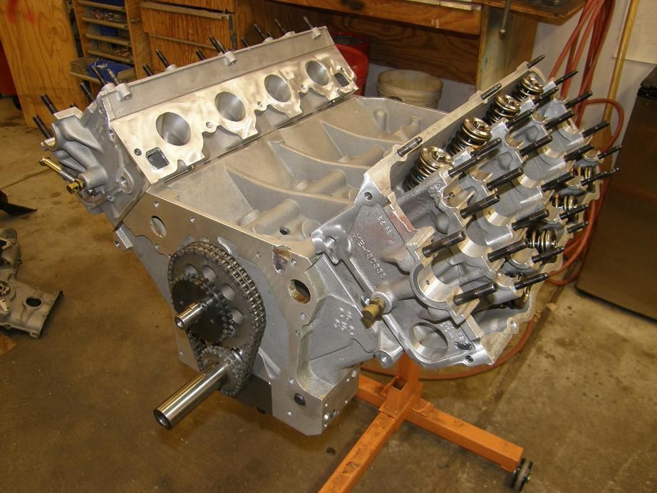

I think a simple solution to the lubrication of the bearings and gear teeth would be to use something like 3/16" brake line tubing or similar and drill .020-.025" holes in it and bend it and direct the flow to wherever it is needed. If you play your cards right, you may be able to get by with one long piece of tubing or two pieces with a t fitting. I would prefer this method because I don't think sealed bearings seem to live very long in general and exposed to excessive heat would surely shorten it's life span I'm sure. Plus the ease of maintenance, not having to pull the front of the engine apart to replace them and worry about bumping the timing accidentally. The oil method "should" be reliable if done correctly. Set it and forget it. :)

Re: SOHC Gear Drive
« Reply #11 on: July 29, 2015, 10:28:57 PM »
Where would you plumb it from? The holes in the sides of the heads or up from the oil pump?
Right from the heads like Jay did on his build here.
