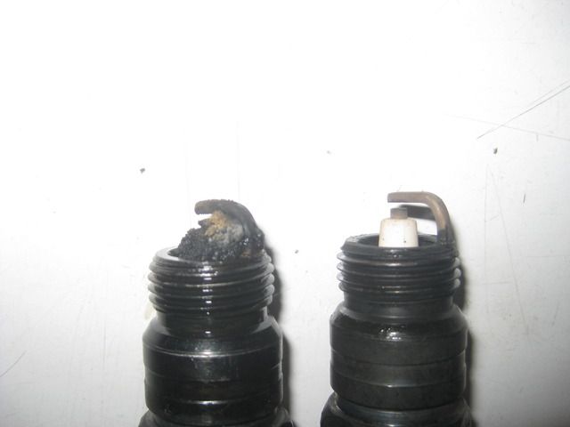

So I put the rocker assembly back in, tossed the valve cover back on. Re-tightened all the intake bolts and tossed a spare plug from a previous tune up in #8. The plug on the left is what I used to get after 40 miles. The one on the right is what I pulled after 40 miles just minutes ago.
What can I say, you guys nailed it!  ;D Thank you everyone for your input!
