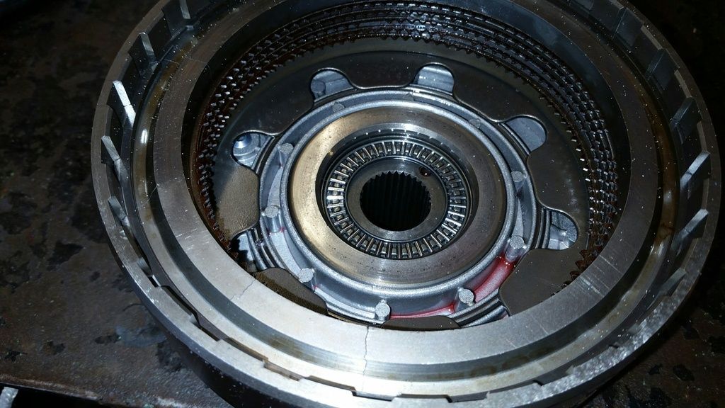

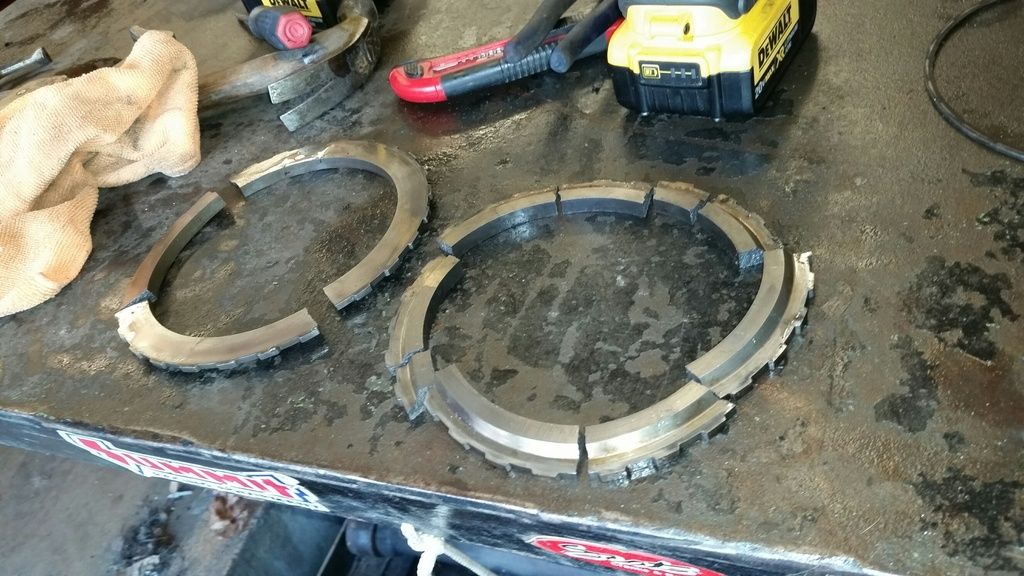

getting it tore down further I did find more problems.  some of the clutches had the hatching wore off.
On the other pack I found both plates broken... .
Not sure any of this will cause a 3 gear flare or not ..... :o

« Reply #14 on: May 03, 2015, 05:36:49 PM »
Direct drum will have just smooth clutches.  If that is they drum you are in, totally normal.
Looks like someone used a bottom plate on the top of that last drum tho to get an extra clutch in.  Generally that is frowned upon and having the drum machined to hold more clutches + a full thickness top plate is a better idea.
If you need some parts, (like a full thickness top plate) drop me a line.  I've got 4-5 parts c6's laying around just for this reason.
