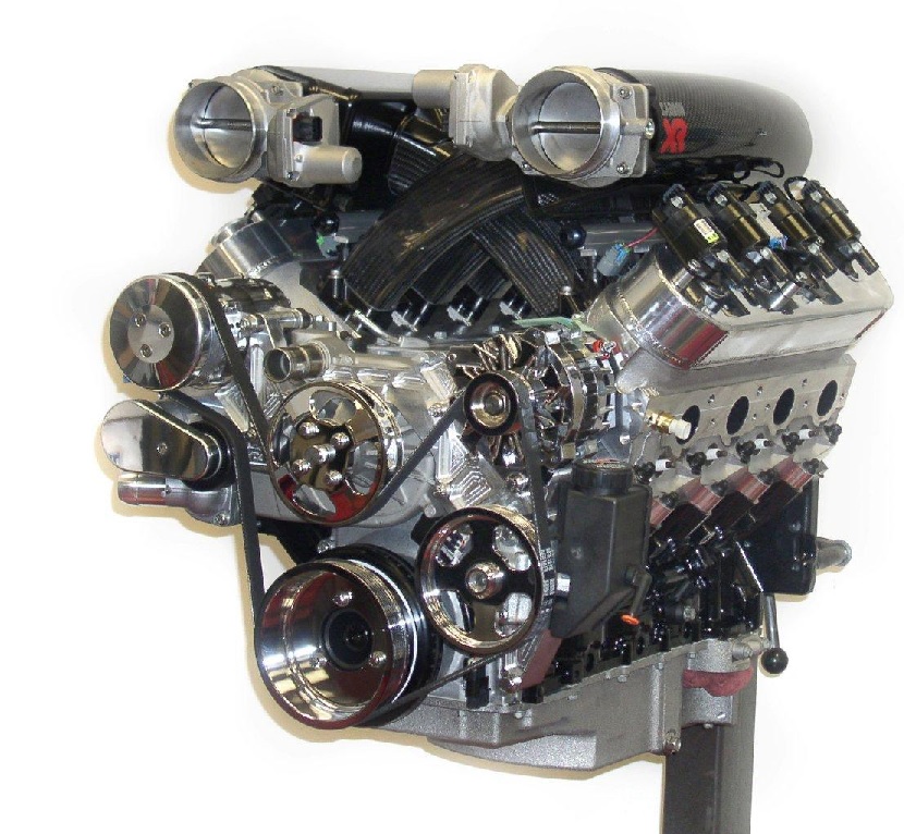

I don't know, Joe, sounds like a lot of work.  One thing I like about CNC machining aluminum is that I can load a casting or a billet into the machine, punch the button, head off for a day of work, and have a finished part on the machine when I get home later that evening.  To do a carbon fiber manifold I would have to build the cores, lay up the fiberglass or carbon fiber, cover it with the vacuum bagging materials and pull a vacuum on the whole thing, then after it dries peel it all apart and dissolve the cores, then clean and trim it up.  Seems like it would be pretty labor intensive; I'll bet I'd have 10-12 hours into each intake manifold, and working a full time regular job just wouldn't permit that.
Here are some pics of some carbon fiber intakes I've looked at in the past:
I always wondered how they got a good joint between the aluminum port sections and the carbon fiber on those manifolds.  Any ideas on how they do that?  I would think that the same kind of epoxy used for the resin, or some variation of that, would crack from temperature cycling.

« Reply #4 on: March 13, 2015, 05:25:51 PM »
The top one is made locally.
I could ask.
I could ask.
If you get the chance, Barry, please do.  No big rush...

« Reply #9 on: March 13, 2015, 06:44:33 PM »
Dalquist could check too - - same guy made the intake for his EMC Pontiac this year.
