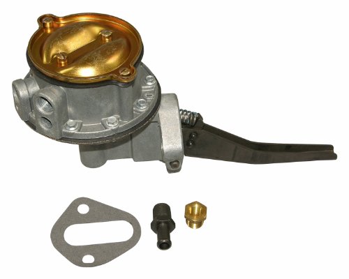

I'm planing a carb/fuel system upgrade this year. Right now I run a 750 vac sec holley and a single n20 kit with the fuel supply run off a mec pump for everything and it works perfect and never goes lean on any full throttle passes. ( I run on board digital air/fuel )

So fuel ! Im on the fence ! I'm dizzy with ideas.  one side of me is thinking a bolt on efi. like fast or msd. My racer side is thinking of switching to E85 to run a little cooler and twist in some more timing. Then on the other side I'm thinking a 850 mec and a return system.

I think you will be hard pressed to get 50 horsepower, but there is likely something in there.  I like the idea of an 850 and was right with you until you said 50 hp, that's a big number
My opinion is that it will take more money to get as much as you want, especially with a 434.  What you did with the juice already is the smartest way IMHO and keep in mind, it is providing oxygen so the carb is probably not an issue at WOT
That being said, I think the car would be very happy with an 850, I think a modern EFI would make it very fun to drive and well mannered.  However, I think if you want more power, there are a couple of more expensive routes to take. A couple of examples, but there are many
