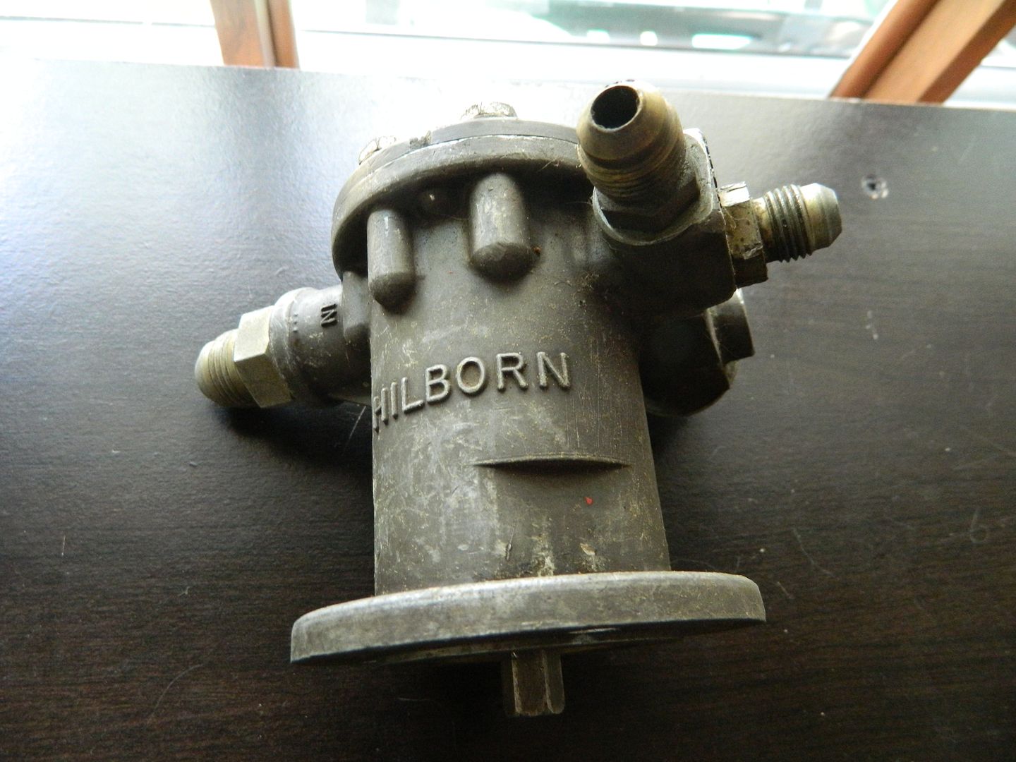

Should include, or option, a removable mechanical fuel pump plate, over the cam.  Sized to match the standard plates use on Enderle, Hilton or moon front covers.
Re: FE Timing Covers
« Reply #20 on: March 09, 2015, 06:24:08 PM »
That's an interesting idea.  Is there a standard size for such a plate?  I'm afraid I have no information on that; it would be nice to have a drawing, or an example to measure...
Dumpling
  • Posts: 410
« Reply #21 on: March 09, 2015, 06:33:15 PM »
It's a standard size plate to fit a standard Hilborn fuel pump.
I'm thinking though that your starting piece of billet would have to be twice as thick because the meat of the pump mounting flange would probably be behind the face of the plate in order to allow for the mounting bolts.

« Reply #28 on: July 16, 2015, 08:09:58 AM »
I have a Hilborn pump if you want the spec's and such.
I'll have to dig it out. ::)
A Hilborn Pump.
