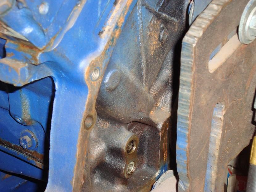

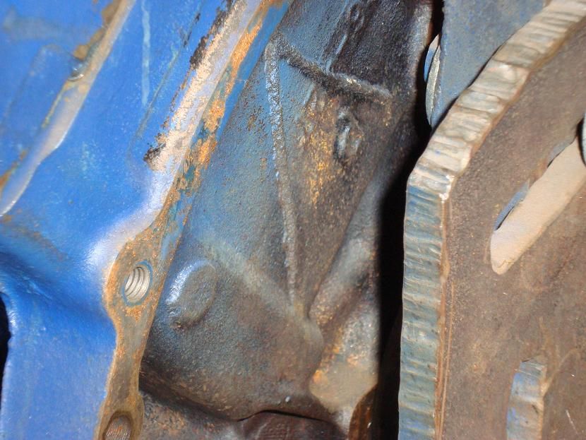

Welcome to Fe's. Yes, it can be very hard to I.D a block. I'll add that not only do you normally need to know the bore and stroke but in some cases a sonic check to know for sure what you are looking at. Many side-oiler 427's and most 428's have a "scratch" mark on the back of the block. It looks like a weld bead and some people mistakenly call it that, but it is actually a scratch that was made in the casting sand of the mold. That is one of the ways Ford used to keep track of what they were making. Look at this picture and you can see a sideways "<" that goes through the 66-427. There are other marks that were used. 428's commonly have a "C" or "A" along with others.
In this next picture below the scratch you can see on the back of the block the side-oiler galley and relief passage have been drilled and plugged.

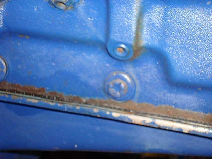

In this photo you can see the "hump" in the side of the block for the side-oiler passage an inch or so above the oil pan. There are 3 small threaded plugs there right above the cross bolts.
Marine 427's were made all 3 ways, as a center oiler, as a side oiler and as a block with an undrilled side-oiler passage. An undrilled side-oiler block would have to have that "hump" on the drivers side of the block.

I have a 1966 date code 427 block that is a side oiler casting but drilled as a center oiler. It is a marine block that was intended for left-hand rotation.  My block has cross bolted mains and must use solid lifters as it was not drilled for hydraulics.
For more pictures, see my earlier post "a tale of two 427s". For more info on block IDs, see Barry R's book "How to build Max Performance Ford FE Engines".  It's available from his website.
