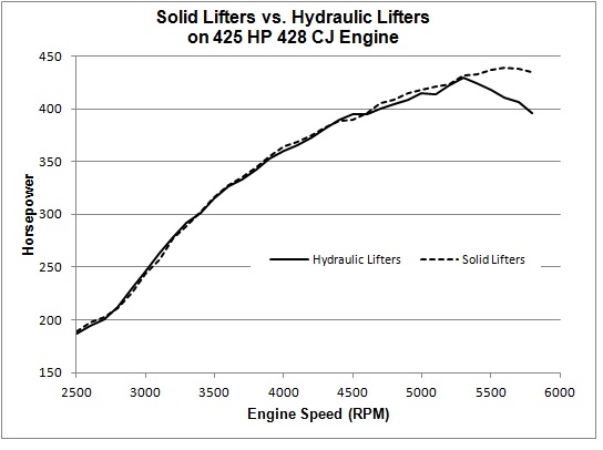

Bare with me for a minute with all the info I am learning. But, if the rpm hydraulic cam is 236 @50 and .572 lift, is that not about the same as a solid 242-248 @ 50 and .560-.590 lift, when you factor in the valve lash? My English teacher always told me not to start a sentence with "but" but some times ya gotta ;D
Nick
I usually don't post pictures from my book online, but I will make an exception here to point out that the hydraulic lifters and the Edelbrock spring setup will give up on your engine around 5300 RPM.  That cam should pull a lot higher, and quite a while back I swapped a set of solid lifters onto the RPM hydraulic cam to see what the difference was.  Here is the graph from page 228 of my book:
Bottom line is that you are leaving a good 30 HP on the table at the top end, running that hydraulic cam.  I don't like hydraulic cams (flat tappet or roller), and this graph is a perfect example why.  There are steps you can take to extend the RPM range, like running more seat pressure and a little higher open pressure,and probably get the cam/lifter/spring setup to work to 6000 RPM, but as that setup is delivered from Edelbrock, this is what you will get.
