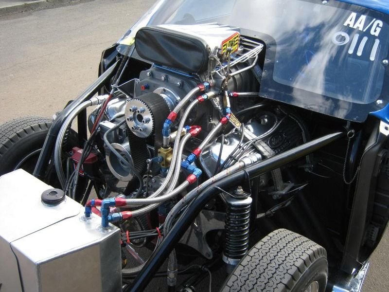

I just got accepted onto this forum (thanks Jay), and thought I would do a little introduction before I posted my questions. I work in a mechanical worksop in Melbourne, Australia. We mainly work on older vehicles and I work there part time while my dad is there full time. The owner of the shop owns a MkI Cortina drag car with and blown and injected SOHC:

Wow, that's one hell of a car! Saw a vid last year on the 'Net (Youtube?) and it really scoots.
Must though be a major pain in the rear to work on the engine with the tight tube frame upper rails and the engine 1/2 way under the cowl. Yikes!
