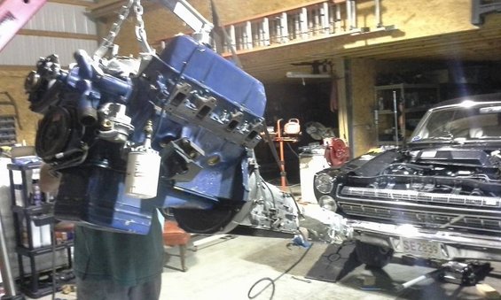

Day one of the swap and it was just short of a disaster. Got a late start and I was a bit apprehensive but slowly and methodically removed and disconnected everything that needed to be. First snafu, I used a different lifting device which I would not use again but with persistence and perseverance and just a little damage to the core support that will be easily straightened but will require repainting I was finally able to get the engine out. The tear down went smoothly with no surprises nor issues other than the mess which was expected and once that was dealt with prepping for the new heads was begun. Second snafu, I compared the header to the gasket for the new heads and discovered that this header absolutely will not work. Several people have made statements that the two would interchange but that a bolt hole or two `would require being elongated and others have suggested that this was not the case. Those in the latter group are correct.

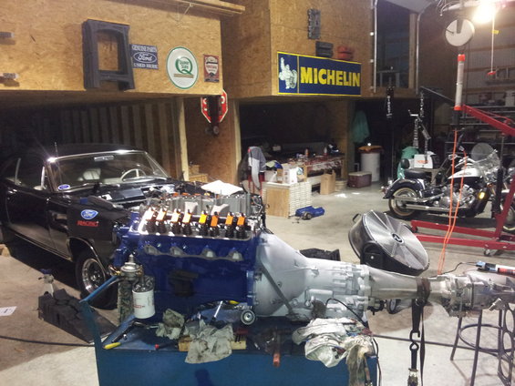

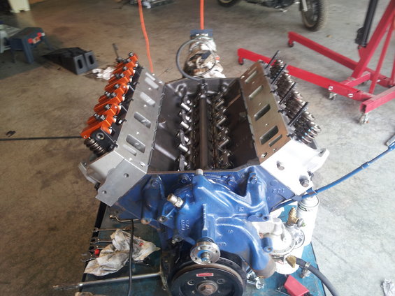

Today saw the valve clearance checked  and the heads installed, I did find a clearance issue with the Harland Sharp end stand hitting the ARP head bolt but a quick pass on the bench grinder and cleanup with a file was all that was needed. I have decided that while the engine is out I will do the front end upgrades, I've had the parts but had been waiting for winter but with the engine out it will make doing the Shelby drop much easier not to mention how much easier the engine will be to drop in without the steering in the way.
GT vs CJ ports-
Engine pulled for swap-
Head on-
End stand clearanced for ARP stud-
Intake sits roughly .030 above head at valve cover-
« Last Edit: September 01, 2014, 08:55:11 PM by SE2839 »

You may want to take the intake and have the valve cover flanges milled down.  A .030" step is more than what I'm comfortable with.
Re: BBM Head Swap
« Reply #10 on: September 03, 2014, 08:48:34 AM »
How much difference is there when you torque the intake down?  I would torque it in place and measure the difference before cutting anything.  The torquing of the intake will leave an imprint on the gasket which will tell you how the intake if fitting around the intake port.  If there is a mismatch upper and lower, then you will need to cut a small amount off both sides of the intake manifold to get a better fit/match.  Joe-JDC
  • Posts: 5394
Re: BBM Head Swap
« Reply #11 on: September 03, 2014, 10:43:39 AM »
Yes, and also check port alignment.

I've been working a lot of overtime the past couple weeks so not much time on the Comet this past weekend, I did manage to mount the intake and probably used too much RTV in the process. I ended with a difference of between .021 and .033 between intake and head at the valve cover surface. Port alignment looks good, bolts were not aligned well at first but my weight applied to the intake displaced the sealant enough that they lined back up. Engine is just about ready to go back in but first a little front end work. Hope that I never need to take it off again.
